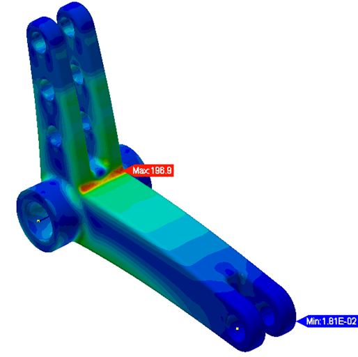

In the first exercise, we used basic boundary conditions (loads at the two ends and a constraint in the middle). We also used default mesh sizing. The results looked like this:

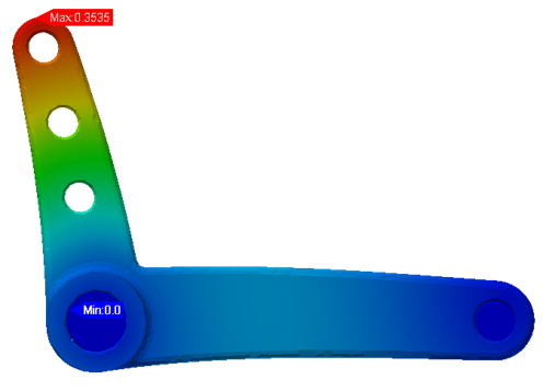

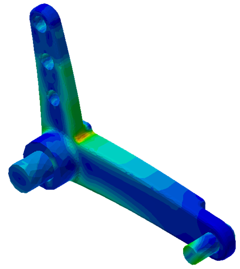

In the second and third exercises, we replaced the incorrect loads and constraints with advanced techniques to produce a more realistic deformation. These included rigid connectors and ball joint constraints. We also refined the mesh in critical areas to produce a solution that is dependent on the mesh. The resultant deformation is shown:

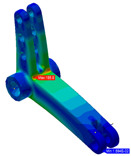

In the fourth exercise, we replaced the constraints with the actual pin parts, we used symmetry to constrain the rigid body motion, and we used contacts to model the interaction and movement between the lever arm and the pins. This combination of techniques produced the most physically realistic analysis scenario and resultant deformation:
