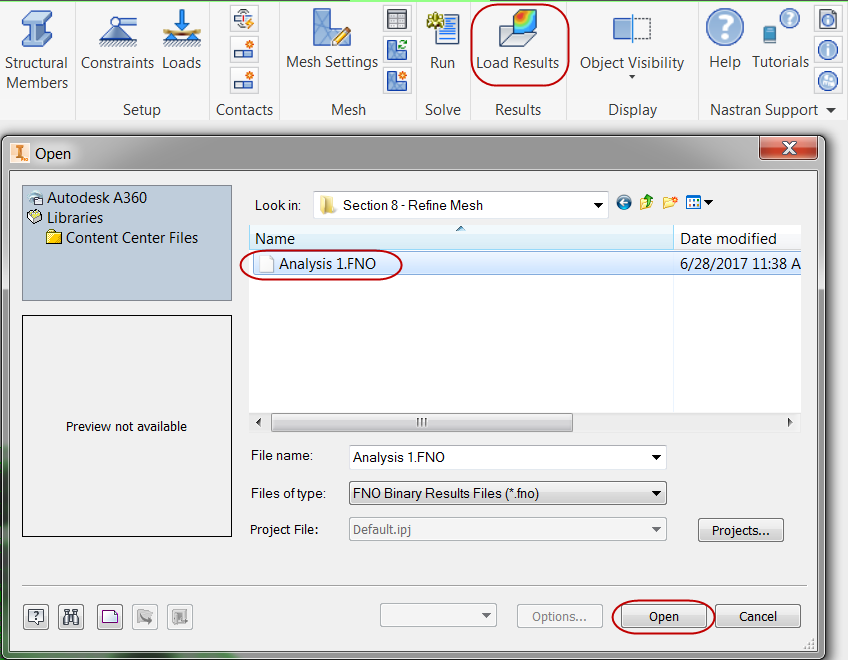

To load the results needed for this exercise, click Load Results from the Results panel, and select Analysis1.FNO, located in the Section 8 - Refine Mesh sub-folder:

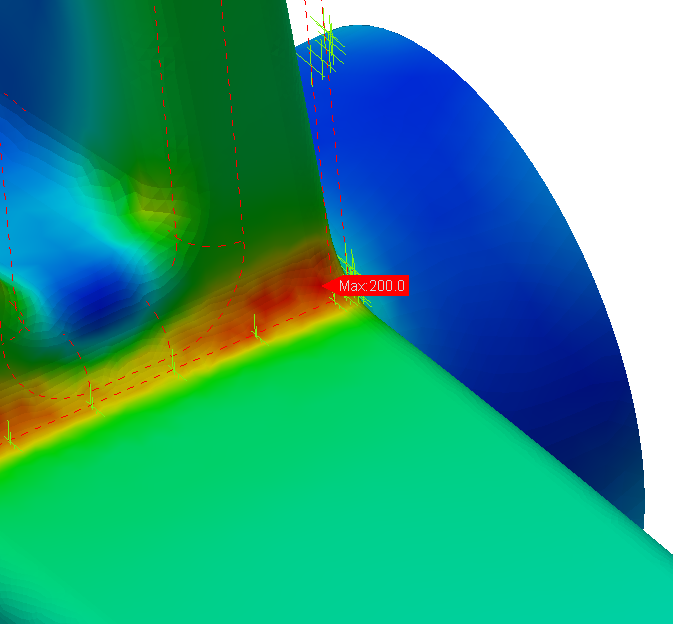

Upon close inspection, the stress results show a few indicators of potential convergence issues. The local face tangency is intermittent. In the following image, you can see that the results on the surface look "rough," and the area of high stress is "spotty."

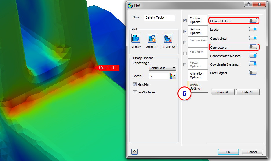

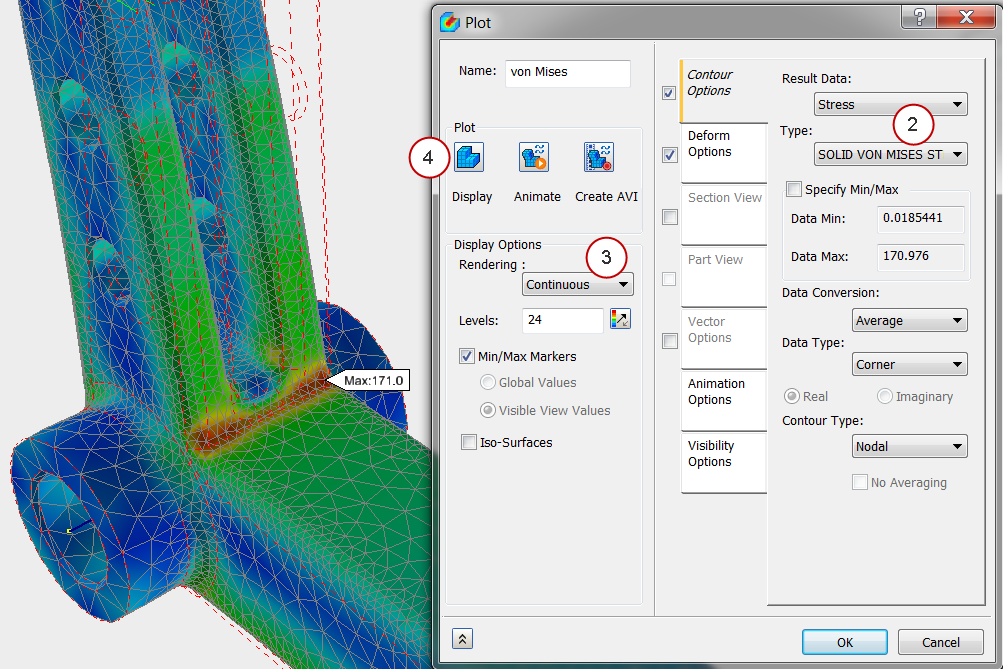

We'll start by displaying von Mises stress on the model and adjusting the rendering options:
  1. Click Options from the Results panel.
  2. On the Contour Options tab, select Stress from the Result Data list, and SOLID VON MISES STRESS from the Type list.
  3. Set the Rendering to Continuous.
  4. Click Display.
  5. To clean up the view, click the Visibility Options tab, and slide the controls for Element Edges and Connectors to the left:

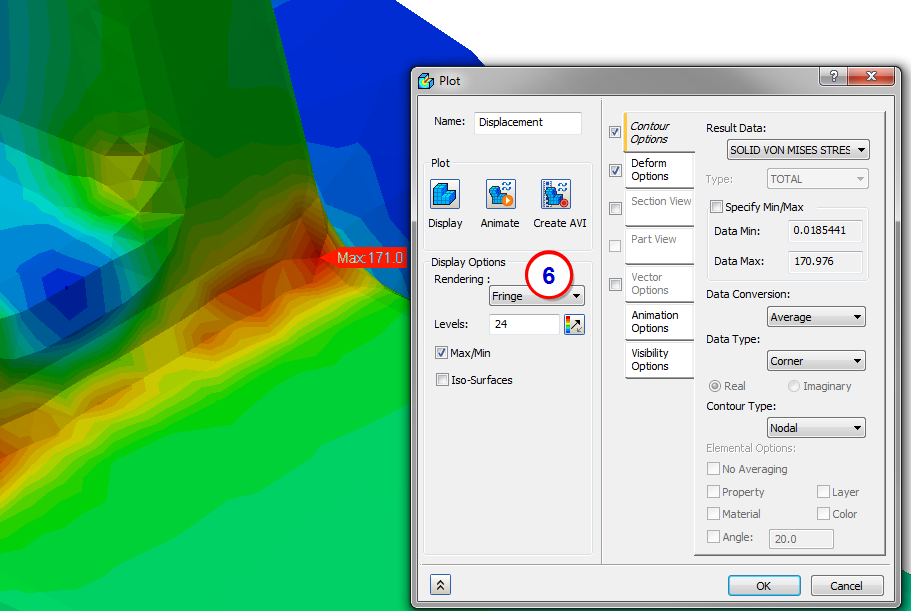

  6. Change the Rendering to Fringe. You can see that the boundaries of the contours are line segments instead of curved lines, and tend to be influenced by the element edges. This indicates that we might need to refine the mesh to improve the results:

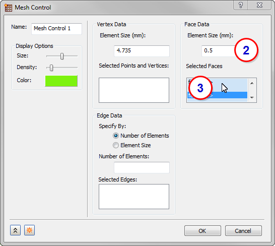

2. Refine the Mesh Locally

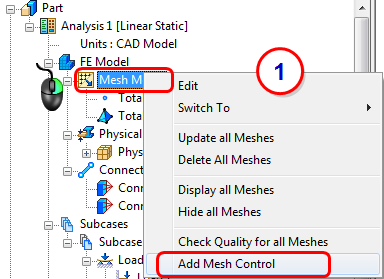

  1. From the Analysis tree, right-click on Mesh Model, and click Add Mesh Control.
  2. On the Mesh Control dialog, set the Element Size to 0.5 mm.
  3. Click in the Selected Faces field.
  4. Select these faces from the model. There should be 9 surfaces in all:
  5. Click OK to close the Mesh Control dialog.

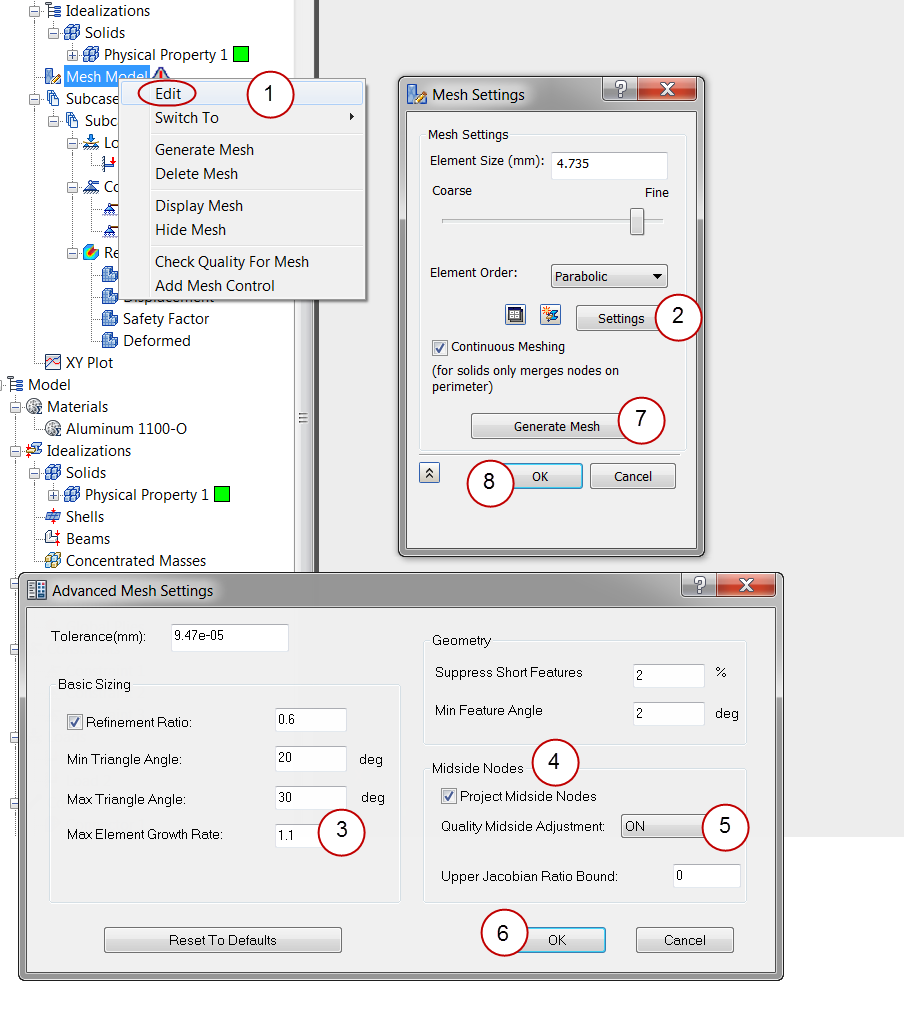

3. Change the Global Mesh Settings
  1. From the Part Tree, right-click on Mesh Model, and click Edit.
  2. From the Mesh dialog, click Settings.
  3. On the Advanced Mesh Settings dialog, change the Max Element Growth Rate to 1.1.
  4. Check the Project Midside Nodes box.
  5. Set Quality Midside Adjustment to ON.
  6. Click OK to close the Advanced Mesh Settings dialog.
  7. Click Generate Mesh to re-generate the mesh.
  8. Click OK to close the Mesh dialog.

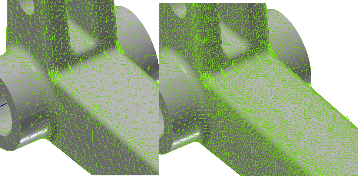

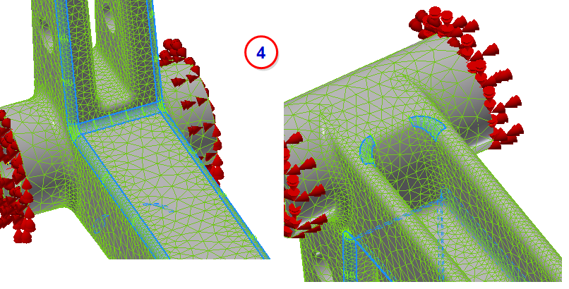

The original mesh is shown on the left, and the new one is on the right:

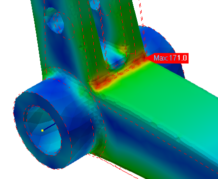

Note that the stress increased nearly 20% in this fillet:
