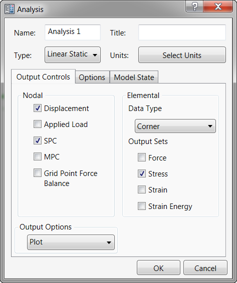

In the previous topics, we explored how to define and apply many of the primary analysis conditions including properties and materials, loads, constraints, and contacts. In this topic, we examine the settings that define the analysis itself. These include the type of analysis, the units, and the default contact type.
When you first start the Autodesk Inventor Nastran environment, the analysis feature has certain default settings. To modify these settings, on the Analysis tree, right-click Analysis > Edit. To create a new analysis, right-click the Part or Assembly at the top of the tree, and select New Analysis. In both cases, the Analysis dialog opens:
In this topic, we will explore the most commonly used settings in the Analysis dialog. For a description of all of the analysis settings, please see the Analysis topic in the User's Guide section.
Units
By default, the analysis uses the unit system defined for the CAD model. To change the units, click Select Units. The Units Settings dialog opens. Select from the Unit System menu:
  • CAD Model: The default unit system defined in Document Settings of the CAD Environment.
  • SI: The MKS system (meters, kilograms, seconds, newton, kelvin and degree).
  • Modified SI: The modified MKS system (millimeters, tonne, seconds, newton, kelvin and degree).
  • English: The British / IPS unit system (inches, pounds seconds square per inch, seconds, pounds, Fahrenheit and degree).
  • CGS: Sets the units as centimeter, grams, seconds, dyne, Celsius and degree.
Note that for models containing multiple analyses, a different unit system can be assigned to each analysis. This setting only applies to the Nastran Bulk Data file that is written out. You will not see a difference in the numbers entered in the user interface.

Nodal Output Control / Elemental Output Control
You can use the Nodal Output Control and Elemental Output Control options to control the quantities written out at the conclusion of the analysis.
For more information, please see the New Analysis topic.
Contact Data
On the Options tab, you can select default settings for generating Automatic contacts.
  • Contact Type: Select from Separation, Bonded, Sliding/No Separation, Separation/No Sliding and Offset Bonded.
  • Tolerance: Specify the maximum distance between contacting entities at which automatic contacts can be generated.
