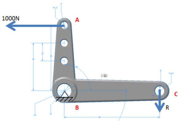

In this exercise, we will conduct a linear static stress analysis of a simple lever arm part. We will use boundary conditions often found in entry-level CAD-based simulation systems. Note that in later exercises we will build on the steps performed here to refine the analysis setup and improve the overall accuracy of the simulation.
The model is a lever arm as shown:
  • A 1000 N load is applied to the top-most hole (A).
  • The lever is pinned at the center (B).
  • We assume a rod passes through hole (C) and is locked against movement.
  • The reaction force, R, balances the loads, so the part is in static equilibrium. A force summation results in R = 687.5 N.

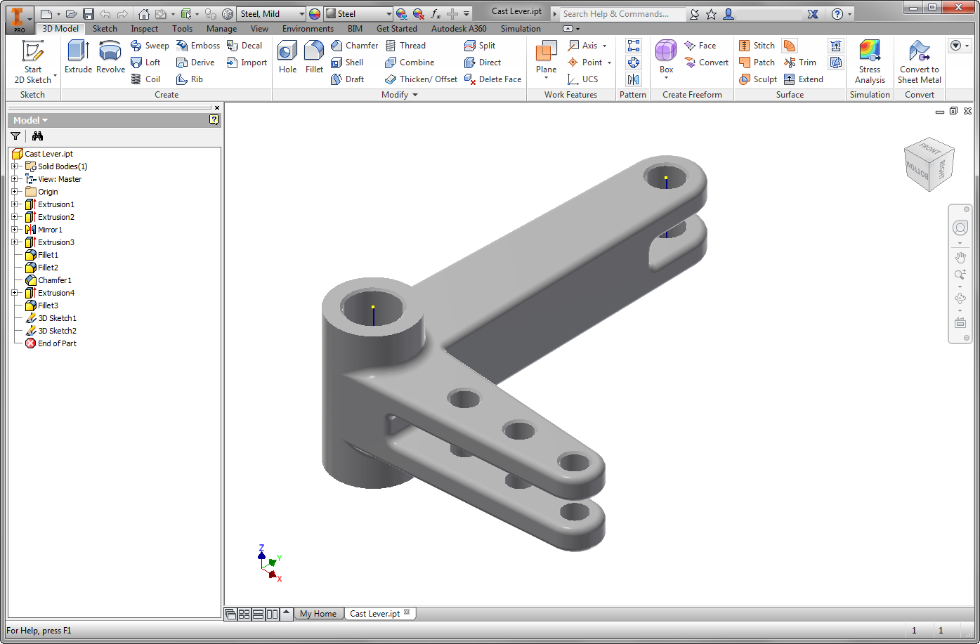

1. Open the Model and Start the Autodesk Inventor Nastran Environment
Start Autodesk Inventor, and open Cast Lever.ipt from the Section 5 - Cast Lever sub-folder of your training exercises folder. (Get Started > Launch > Open).
You should see this:
From the ribbon, click the Environments tab, and click Autodesk Inventor Nastran:

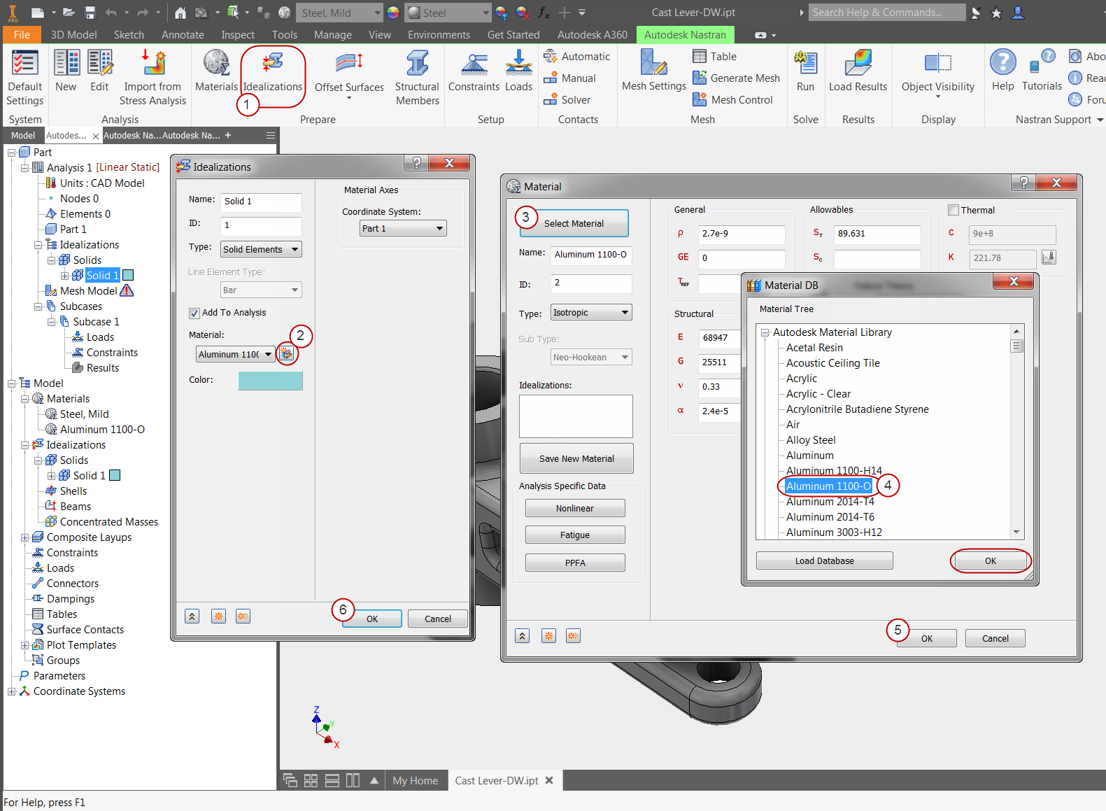

2. Define the Physical Property
In the Model tree, expand the Idealizations node to check for any existing definitions, such as Solid 1. If any exist, right-click Idealizations > Delete All. Doing this ensures that you won't have unwanted materials appearing in the part mesh and the analysis.
  1. Click Idealizations on the ribbon.
  2. On the Idealizations dialog, click the New Material icon.
  3. On the Material dialog, click Select Material.
  4. On the Material DB dialog, expand the Autodesk Material Library list, and select Aluminum 1100-O from the list. Click OK.
  5. Click OK on the Material dialog.
  6. Click OK on the Idealizations dialog.

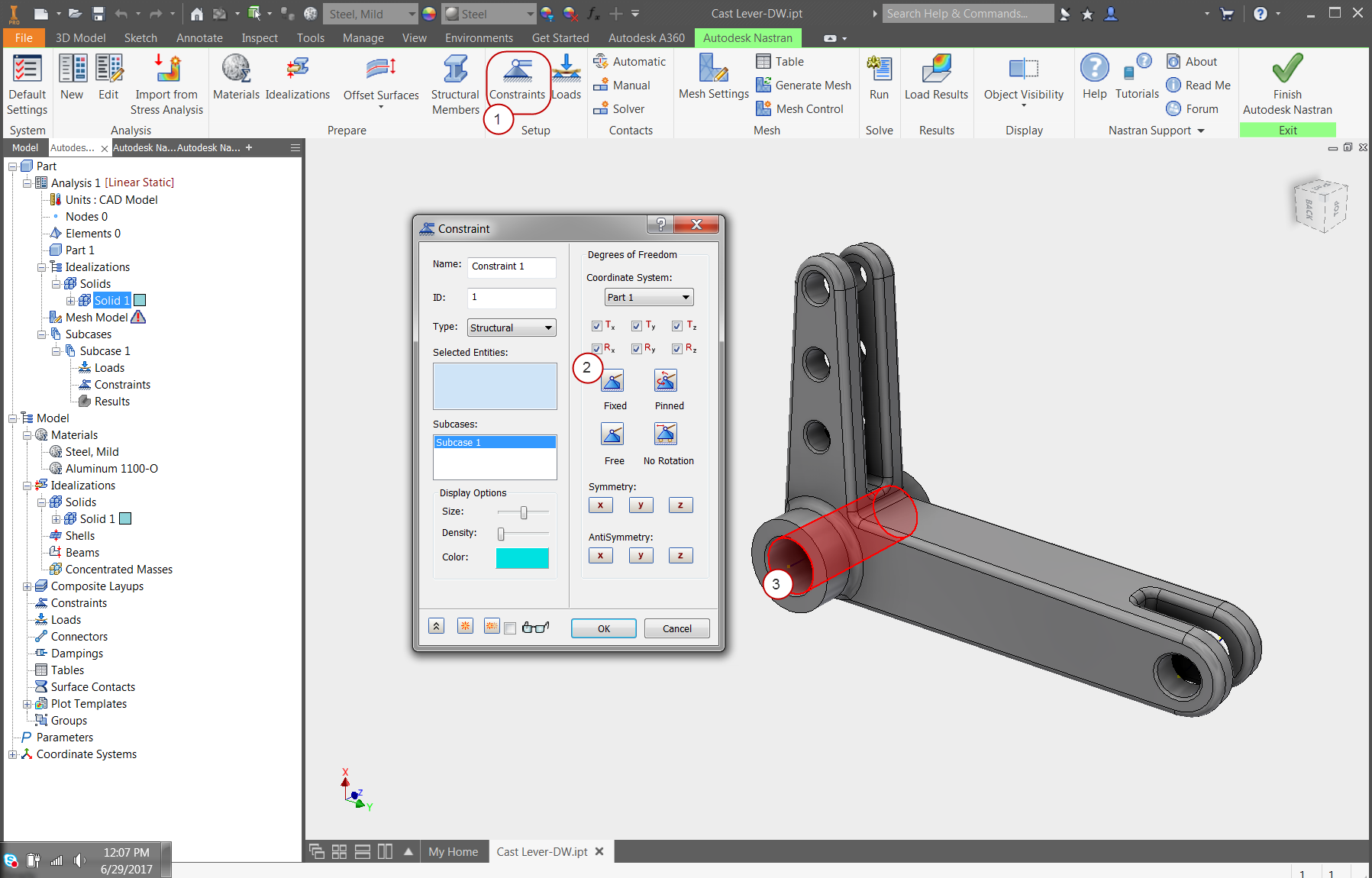

3. Constrain the Lever
  1. Click Constraints from the ribbon.
  2. Make sure the Fixed constraint is specified. (It is the default setting.)
  3. Select the inside surface of the center hole (as shown), and click OK.
Note: Because the loads are balanced, we don't expect any rotation about this axis. This is why we have applied a fixed constraint at this location.

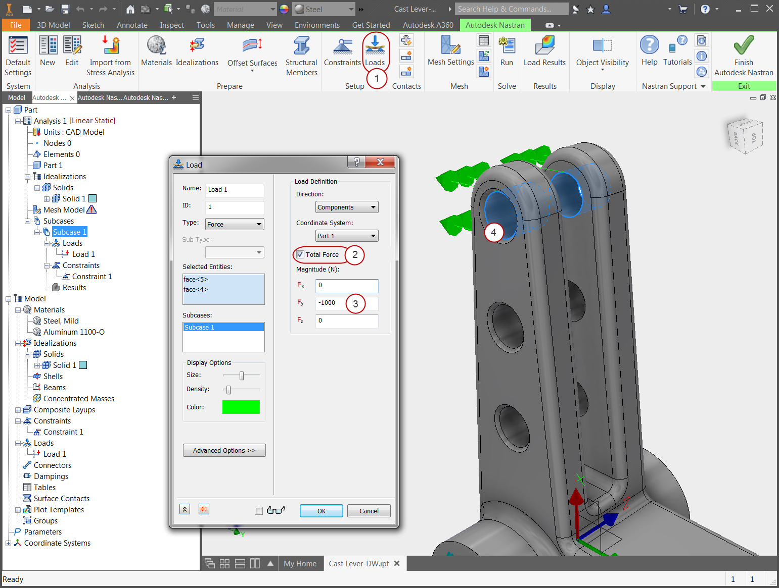

4. Define the First Load
  1. Click Loads from the ribbon.
  2. Select the inside surfaces of the two holes as shown.
  3. On the Load dialog, check the Total Force box.
  4. Enter a load of -1000 for Fy, and click OK.

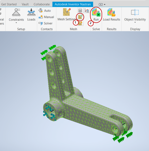

6. Mesh the Part and Run the Analysis
  1. Click Generate Mesh from the ribbon.
  2. After the mesh generates, click Run to start the analysis.
Note: While the simulation runs, the Model Tree changes to show the Autodesk Nastran Output. You may see red messages in the output. These indicate that Autodesk Nastran identified elements that are poorly shaped. We will ignore these warnings for this exercise.

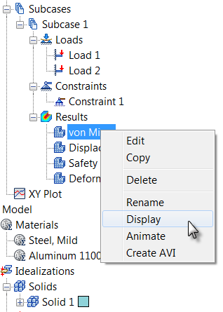

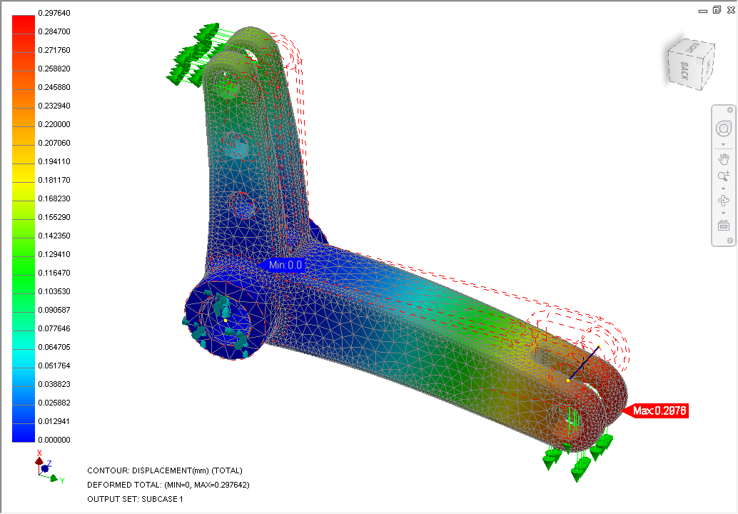

7. Review the Results

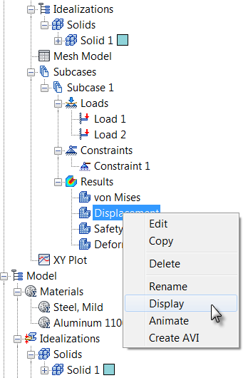

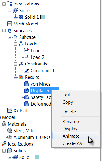

To plot displacement, right-click on Displacement from the tree, and click Display:

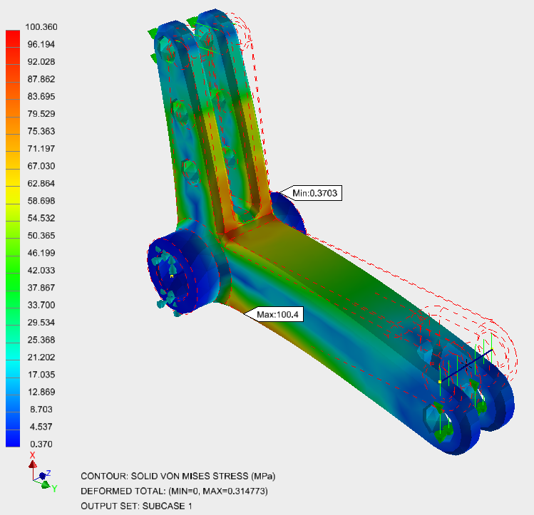

To animate the displacement, right-click on Displacement, and click Animate:
To stop animation, right-click on Displacement, and click Animate so that it is unchecked.

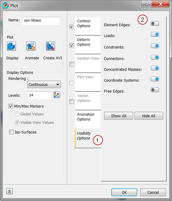

To plot von Mises stress, right-click von Mises > Display.
To turn off the element edges, right-click von Mises > Edit, then in the Plot dialog, click the Visibility Options tab, and click the Element Edges slider to move it to the left.

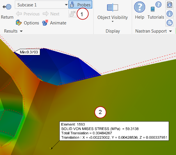

8. Probe for a Specific Value
  1. Click the Probes command from the ribbon.
  2. Hover over a location on the lever arm. The results are displayed:
