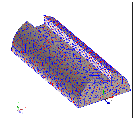

Surface U Direction (Positive)
In this method, the tangent vector along the u direction of the surface parameter space at a point closest to the element origin is projected on the element x-y plane to compute the material orientation.
The model shown in the figure above has a complex lofted geometry.
The Surface U Direction method effectively handles the orientation definition along the surfaces’ parametric space u vector.
