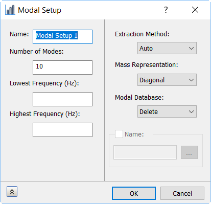

To set these up, in the Part tree, under your Subcase, right-click Dynamics Setup, Modal Setup, or Quasi-Static Setup and select Edit. Settings for Quasi-Static Setup are the same as shown below for Dynamics Setup, except that the default Name is Quasi-Static Setup.

Name: Names the Solution Frequencies defined.
ID: The ID of the property is automatically updated by Autodesk Inventor Nastran, similar to Materials.
Frequency Limits:
  • Lowest Frequency (Hz): This is the lowest frequency in the frequency range of interest for a Frequency Response analysis. This quantity is defined in Hz.
    • In a Modal Frequency Response solution Lowest Frequency uses the parameter LFREQ in the Bulk Data file. This cuts off any frequencies below this number. The denotes that this is written out as a parameter.
  • Highest Frequency (Hz): This is the highest frequency in the frequency range of interest for a Frequency Response analysis. This quantity is defined in Hz.
    • In a Modal Frequency Response solution Highest Frequency uses the parameter HFREQ in the Bulk Data file. This cuts off any frequencies above this number. The denotes that this is written out as a parameter.
