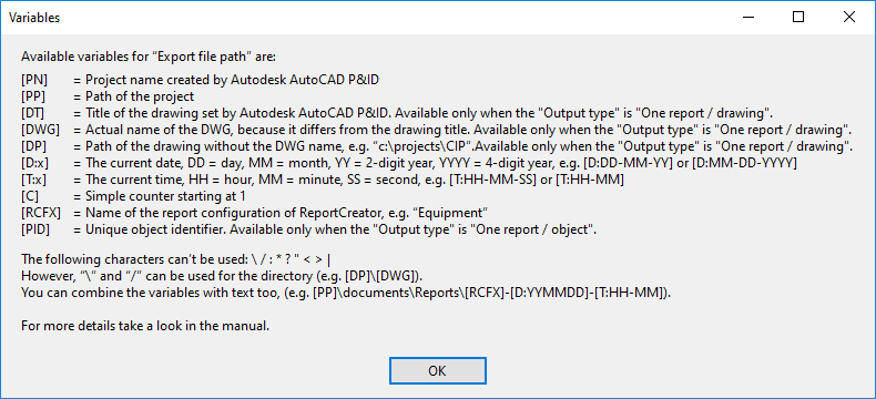

    Variables Dialog Box
    List the variables available for defining the export file path and rules for using the variables.
    Example: [PP]\Documents\Reports\[RCFX]-[D:YYMMDD]-[T:HH-MM] can produce this result: C:\Projects\Water treatment AUF-0245\Documents\Reports\Equipment list-080804-16-45.pdf
    Parent topic: Report Creator
