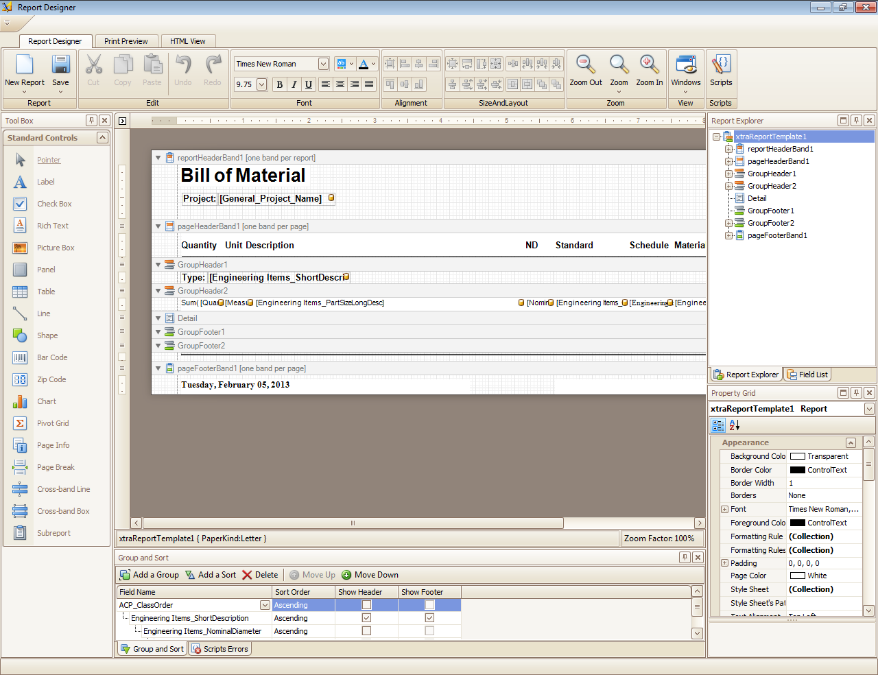

Report Designer Dialog Box
Specifies the report layout.
Standard Controls
Lists the available objects that you can add to your report.
Report Explorer
Shows the structure of a report in a tree form, providing easy access to report elements. Select an element to change its settings using the Property Grid.
Property Grid
Specifies the settings of the currently-selected report element.
Field List
Serves the following purposes:
  • Displays the list of all available data fields (attributes you can show in your report) and allows you to create report elements that will show information from these fields.
  • Allows you to create calculated fields by building expressions based on the values of data fields, report parameter values, and so on.
  • Shows existing report parameters and allows you to add parameters to the report.
Group and Sort
Applies grouping and sorting to report data.
