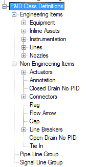

  1. In the Project Setup tree view, expand P&ID Class Definitions.
  2. Continue to expand the list until you locate and click the component or line whose linetype you want to change.
