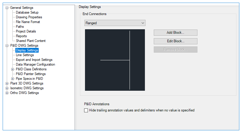

  1. On the ribbon, click Home tab Project panel Project Manager Project Setup.
  2. In the Project Setup tree view, expand P&ID DWG Settings.
  3. Click Display Settings.
  4. On the End Connections pane, click Add Block.

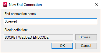

  5. In the New End Connection dialog box, enter a name for the new end connection.

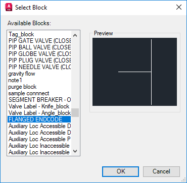

  7. In the Select Block dialog box, locate and click a drawing that contains the block you want to use for the end connection symbol. Click Open.
  8. In the Select Block dialog box, in the Available Blocks list, select a block to use for the end connection.
    A preview image of the block you selected displays.
  9. Click OK.
  10. In the New End Connection dialog box, click OK.
