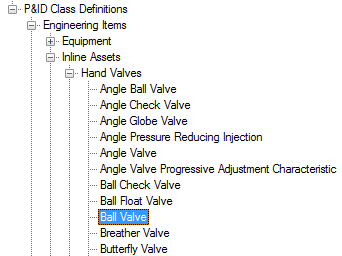

  1. In the Project Setup tree view, expand P&ID Class Definitions.
  2. Continue to expand the list until you find the valve or inline instrument to which you want to assign the end connection.
  3. Select a valve or inline instrument (for example: Ball Valve).

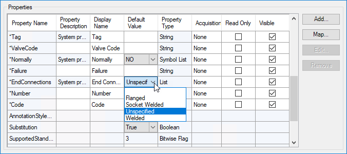

  4. On the Class Settings pane, under Properties, in the Property Name column, locate EndConnections.
  5. In the EndConnections Default Value drop-down list, click an end connection type.
  6. Click OK.
