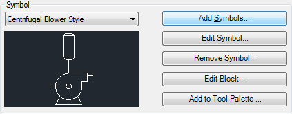

Symbols represent how components display graphically in a P&ID drawing. If you have custom valves or pumps, for example, you can create specific graphical representations for them and add them to the tool palette.
  1. In the Project Setup tree view, expand P&ID Class Definitions.
  2. Continue to expand the list until you locate and click the component or line whose symbol you want to add. Or, if you have several symbols to add you can click any item on the tree that displays an active Add Symbols button in the right pane (clicking Inline Assets, for example, enables the Add Symbols button).
  3. On the Class Settings pane, under Symbol, click Add Symbols.
  4. In the Add Symbols - Select Symbols dialog box, click the [...] button.
  5. Navigate to and select one or more drawing files that contain the blocks you want. Click Open.
