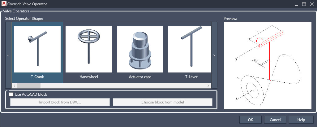

You can specify a different operator after the valve is placed in the 3D model. It is not necessary to add the operator to a piping spec or catalog.
- Select Operator Shape
Specifies a parametric shape for the operator.
- Use AutoCAD block
- Specifies a block-based component if selected.
- Import Block from DWG
Specify a drawing and displays the Select Block Definition dialog box.
You can import blocks from a drawing after using plantpartconvert.
- Choose Block from Model
Selects a block reference in the model.
