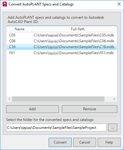

Convert AutoPLANT Specs and Catalogs Dialog Box
Converts AutoPLANT specs or catalogs for use in AutoCAD Plant 3D toolset.
Note: If conversion fails, you can check the log file for possible reasons. If the log file states “Cannot convert file. Open file in latest AutoPLANT spec generator. Then retry conversion,” your spec lacks the class information required for conversion. Upgrading your spec by opening it in the latest version of the AutoPLANT spec generator supplies the missing information. You can then migrate the spec to Plant 3D.
List of Options
Add External Specs and Catalogs to Convert to AutoCAD Plant 3D toolset
Lists the AutoPLANT specs or catalogs that you add for conversion.
Add
Adds a new spec or catalog to the list of files for conversion.
Remove
Remove Deletes specs or catalogs from the list of files for conversion.
Select the Folder for the Converted Specs and Catalogs
Specifies the output folder for the converted specs and catalogs.
