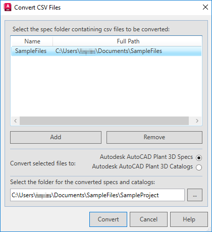

Convert CSV Files Dialog Box
Converts an external spec or catalog for use in the AutoCAD Plant 3D toolset.
List of Options
Select the Spec Folder Containing CSV Files to be Converted
Lists the folders containing CSV files that you add for conversion.
Add
Adds a folder location to the list of folders containing CSV files for conversion.
Remove
Deletes folders from the list of folders containing CSV files for conversion.
Convert Selected Files To
Specifies whether the CSV files are to be converted to specs or catalogs.
Select the Folder for the Converted Specs and Catalogs
Specifies the output folder for the converted specs and catalogs.
