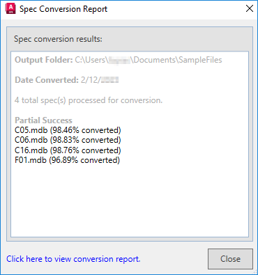

Spec Conversion Report Dialog Box
Lists the conversion results for specs or catalogs migrated from AutoPLANT to Plant 3D format.
List of Options
Spec Conversion Results
Lists the output folder location, conversion date, and the number of components that failed to convert. Also lists the components that were not converted.
Click Here to View Conversion Report
Opens the detailed conversion report in Microsoft Excel.
