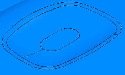

Resize to Fit — Use this option to adjust the view to see the entire model.
It converts this:
to this:
