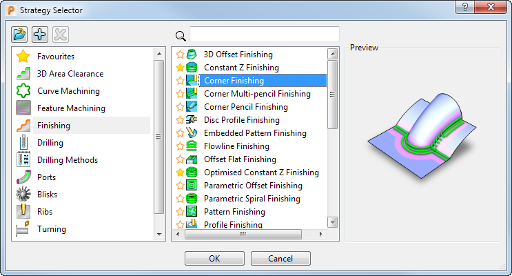

  1. Click Home tab > Create Toolpaths panel > Toolpaths to display the Strategy Selector dialog.
  2. Select the Corner Finishing strategy on the Finishing tab, and click OK.

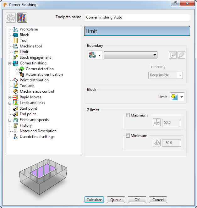

  3. In the Corner Finishing dialog:
    1. In the Toolpath name field, enter CornerFinishing_Auto.
    2. Select the Limit page and choose None from the boundary list.
