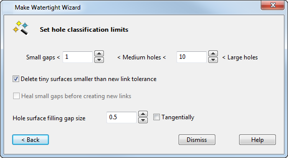

Set hole classification limits
— Use the up and down arrows to set the minimum hole width for medium holes.
— Use the up and down arrows to set the maximum hole width for medium holes.
Delete tiny surfaces smaller than new link tolerance — Deselect this option to limit the maximum linking tolerance to the smallest size. Select this option to limit the maximum linking tolerance to the largest small gap size.
Heal small gaps before creating new links — Heal small gaps to the present solid tolerance before attempting to link the gap to a larger tolerance.
— Use the up and down arrows to set the maximum permitted size of the gap in the boundary of any filled holes.
Tangentially — Select this option to createthe surface tangent-continuous to adjoining surfaces.
Back — Return to the first page of the Make Watertight Wizard.
Dismiss — Close the Make Watertight Wizard without applying any changes.
