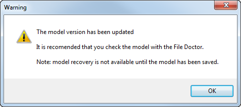

Run File Doctor interactively when Model updated is selected and the model version has been updated, the
File Doctor is run interactively. The following warning dialog is displayed:
Tip: You are recommended to run File Doctor when opening an old version model in a version of PowerShape that uses a later version model. However, if you select Close on the File Doctor dialog, the model is unchanged. - If

- If
Run File Doctor interactively when Model updated is selected (default) and the model version has been updated, the
