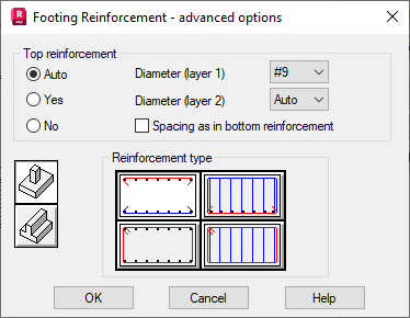

Footing Reinforcement - advanced options dialog
The Footing Reinforcement - advanced options dialog allows you to define the advanced reinforcement parameters of the footing.
Access
Select RC Design Provided reinforcement layout, and then create a new RC element or open an existing one.
  • Click Analysis Reinforcement Pattern, and then click Advanced to open Footing Reinforcement - advanced options dialog.
  • Click (Reinforcement Pattern), and then click Advanced to open Footing Reinforcement - advanced options dialog.
Dialog elements
Top reinforcement
Specify the top reinforcement parameters.
If the Auto option is selected, the necessity of top reinforcement is determined automatically.
Diameter - Select the top reinforcement diameter, irrespectively of the first and second layer.
Spacing as in bottom reinforcement - Imposes top bar spacing identical to bottom reinforcement spacing.
Reinforcement type
Defines the reinforcement method of the footing with respect to longitudinal reinforcement. Independent settings may be defined for footing and continuous foundation.
