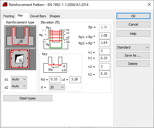

Reinforcement Pattern dialog - Pier tab - Hinges or Socket (RC foundation)
The Pier tab allows you to define the reinforcement parameters of the pier.

Reinforcement type
Select the inset shape for a vertical and horizontal reinforcement of a socket with the reinforcing bar diameters.
Select the basic reinforcement shapes and diameters of the horizontal and vertical insets. Once the basic reinforcement shape is determined, you can indicate a specific inset shape on the Shapes tab (both vertical - pier reinforcement and a horizontal - a stirrup). If the d1 and d2 diameters are the auto value, the diameters according to the defined spacings and in connection with the operating load are selected.
Elevation
Define a zone range of the horizontal reinforcement on the pier height and the reinforcement spacing in each of the zones.
The Rp field (not available) informs about the pier depth defined in the pier geometry.
Key
Define the key properties fixing the steel column anchors in a case of the pier with one or two hinges.
The options located in the Key field are the additional parameters to be defined when the calculations of the foot with one or two hinges are performed. The key (in the bar shape) defines the element of the bolt anchor fixing the base of the steel column.
