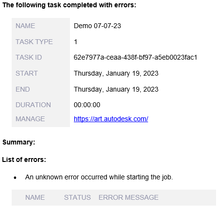

An unknown error occurred while starting the job.
CONTEXT:
Shown as the first line of an email report.
POSSIBLE CAUSES:
- Rate limit reached on folder creation and/or file listing.
- May be a document that is missing required back-end data.
- The volume of files is too large (a combination of file size and quantity of files).
STEPS TO TAKE:
- Try running the task again. If a folder creation limit is hit, then the partially created destination tree will remain, so the limit will not likely be hit again. Try running the task multiple times.

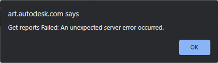

Get reports Failed: An unexpected server error occurred.
CONTEXT:
Pop-up error box when saving a task.
POSSIBLE CAUSES:
- Too much data returned or a data error.
STEPS TO TAKE:
- If the issue still persists, post on the Beta Forum.

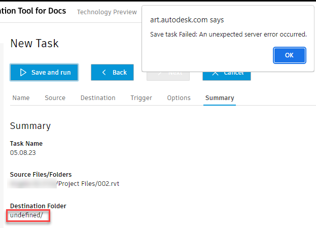

Save task Failed: An unexpected server error occurred.
CONTEXT:
POSSIBLE CAUSES:
- You are missing required task options.
- The task is too large (too many files/folders).
STEPS TO TAKE:
- Try running the task again. Ensure all the required fields are selected as part of creating the task.
- Split the task into multiple tasks of 200 or less total files/folders.

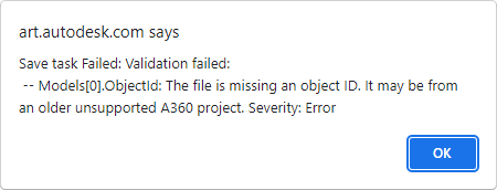

Save task Failed: Validation failed: -- Models[0].Objectid: The file is missing an object ID. It may be from an older unsupported A360 project. Severity: Error
CONTEXT:
POSSIBLE CAUSES:
- A data error, usually caused by choosing an old A360 Team project as your source.
STEPS TO TAKE:
- ART is unable to copy files from your project due to its age and initial configuration. Please contact your Autodesk representative.
