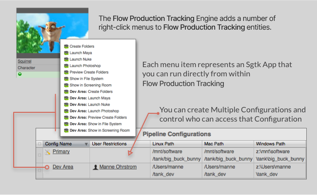

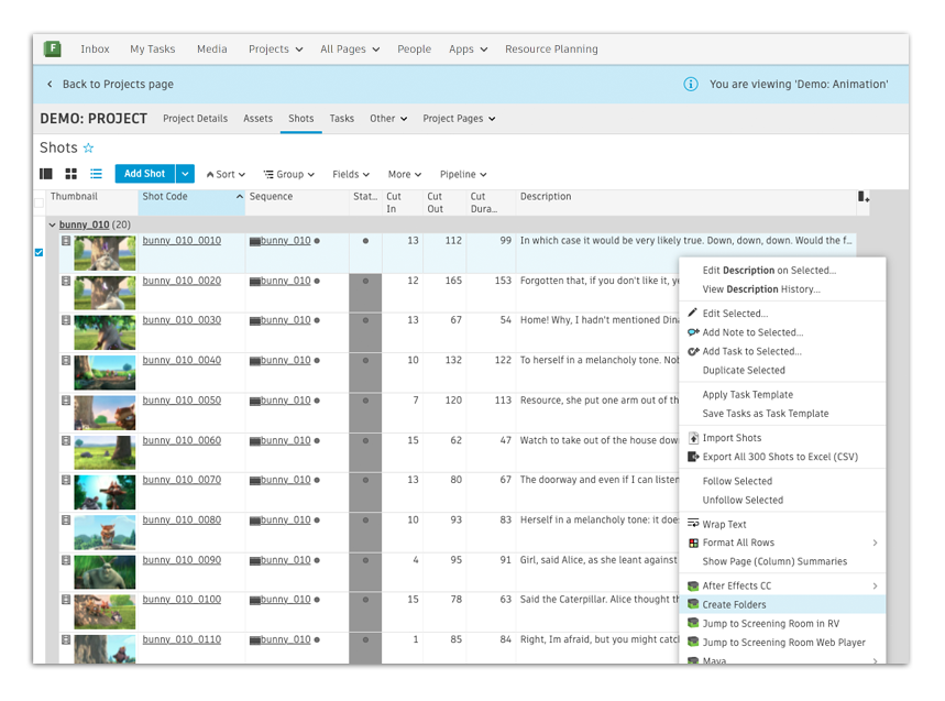

Actions are visible on the Flow Production Tracking:
action1

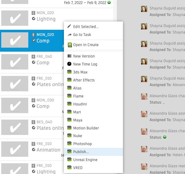

They can also be found on the standard Flow Production Tracking context menu, which can be shown by right clicking on an object or a selection:
action1
