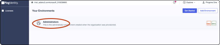

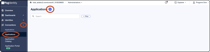

  1. Open the PingOne Admin Portal and sign in as an administrator. Click Administrators to begin.
  2. In the navigation, click Connections > Applications
  3. Click Applications +

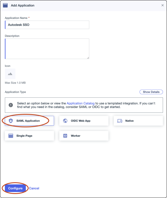

  4. In the Application Name field, specify  Autodesk SSO, select SAML Application from the options, and click Configure.

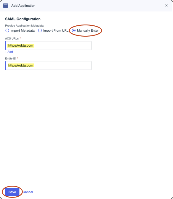

  5. Select Manually Enter and enter these dummy values: 
  • ACS URLs : https://okta.com
  • Entity ID : https://okta.com
  1. Click Save to save the values.

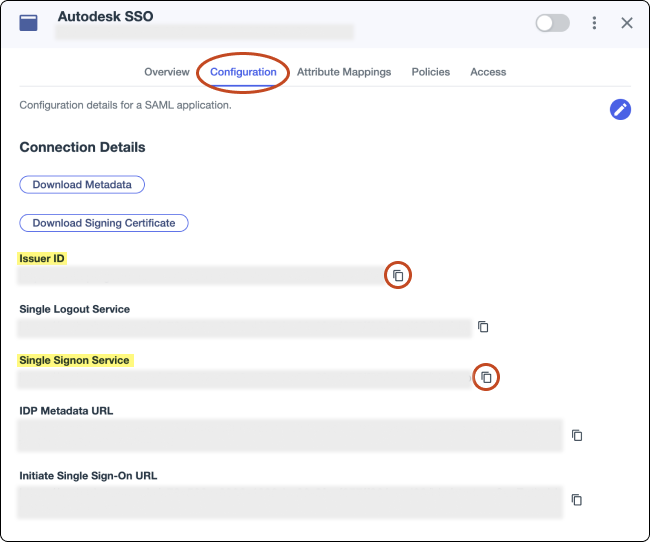

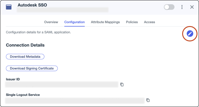

  4. Switch to PingOne portal. Click Configuration and copy the Issuer ID from PingOne. Switch to Autodesk Account and paste this value in the Entity ID field.
  5. Go back to PingOne, copy the Single Signon Service. Switch to Autodesk Account and paste this value in the Sign-on URL field.

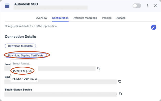

  6. Next, go to PingOne, and under Connection Details, click Download Signing Certificate > X509 PEM (.crt). Switch to Autodesk Account, in the Identity Provider Certificate field, click Upload the Certificate to upload X509 PEM (.crt).

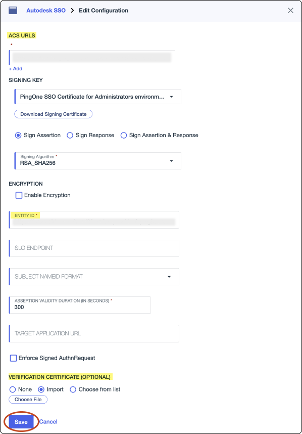

  2. Switch to PingOne portal and click on Edit icon.
  3. From Autodesk Account, copy the Entity ID and paste it into the Entity ID field in PingOne.
  4. From Autodesk Account, copy the Assertion Customer Service (ACS) URL and paste it into the ACS URLS field in PingOne.
  5. From Autodesk Account, download the Verification certificate and under Verification Certificate in PingOne, click Import > Choose file and select the Autodesk Verification certificate. Click Save to save the values. PingOne does not require the Sign-on URL from Autodesk account so you can ignore this field.

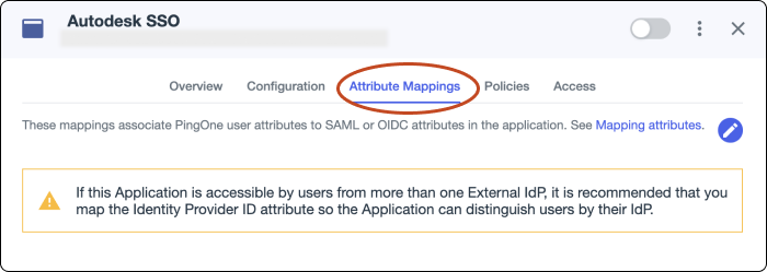

  1. Still in PingOne, click Attribute Mappings, and map these attributes according to the table.

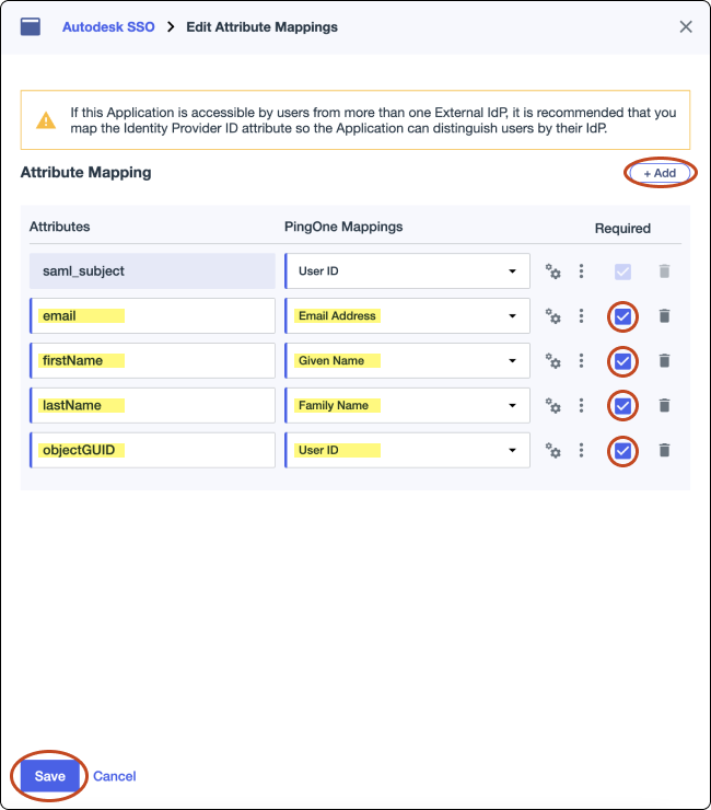

Autodesk attributes PingOne attributes names
email Email Address
firstName Given Name
lastName Family Name
objectGUID User ID
Note:
Example: Click + Add to add in new row of attribute. In the Attributes field, enter email. In the PingOne Mappings, click the drop-down select Email Address. In the Required field, select the Checklist box.
Similarly, map the other attributes (firstName, lastName, objectGUID). After you confirm that the attributes are mapped correctly, click Save to save the values. 

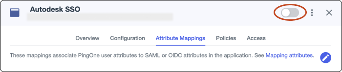

  1. To test your connection, go to the PingOne portal, click the Toggle to enable user access to the application. Only admins of the application are given automatic access to the application. To add new users, go to Identities > Group. View PingOne documentation Adding users to group for more information.

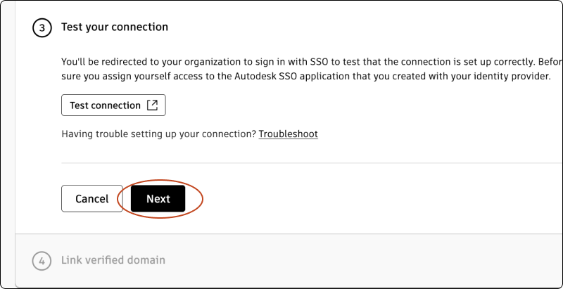

  2. To test your connection, Switch to Autodesk Account, click Next to go Step 3 – Test your connection and click Test Connection to be redirected to your organization’s SSO sign-in page. (If you are not redirected, see Troubleshooting).
  3. Sign in with your organization email and password to make sure that the SSO connection between PingOne and Autodesk is set up correctly. If the test is successful, you will see the message “Connection Test Result: Success” and a list of properties.
  4. Confirm that the attributes have mapped correctly by comparing the Property and Value columns. The property “first name” should appear next to the user’s first name, “last name” should appear next to the user’s last name, and so on. If you need to make changes, return to your PingOne portal and re-map the attributes.
  5. Once you have confirmed that attributes are mapped correctly, close the tab to return to Autodesk Account and click Next.

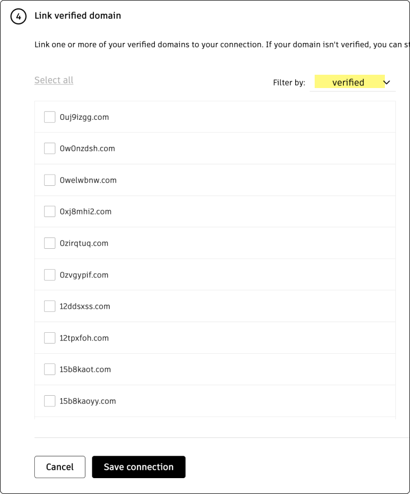

  1. You will see a list of your verified domains. Select one or more verified domains to link to your connection.
  2. Click Save connection to complete the setup.
Note:
If a domain is not verified, you can still save the connection and link it later. If you have not added or finished verifying domains, go to Add and verify domains to complete the process.
