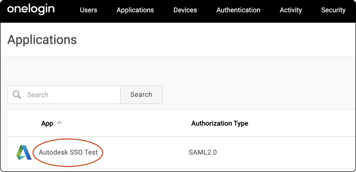

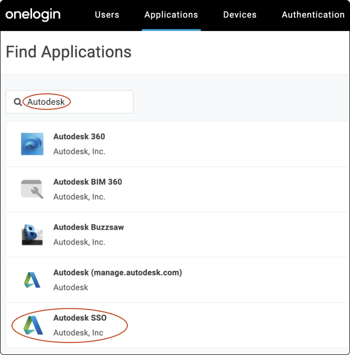

  1. Type Autodesk SSO in the search box, then select the Autodesk SSO application (SP).
    Note:
    This application is pre-configured with all the essential settings including the SAML attributes mapping. Refer to the manual configuration procedure in case of any issues with the Autodesk pre-configured template or to view/update the SAML mapping source.

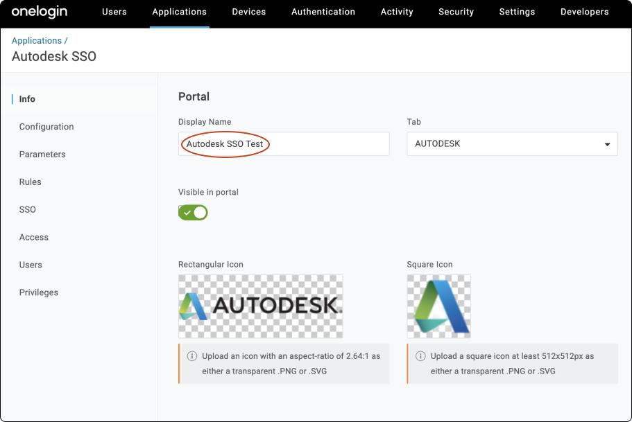

  2. Specify a unique name in the Display Name box and click SAVE.
    Note:
    You can specify any name for establishing the connection. Here we have used Autodesk SSO for the Display Name field.

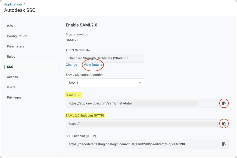

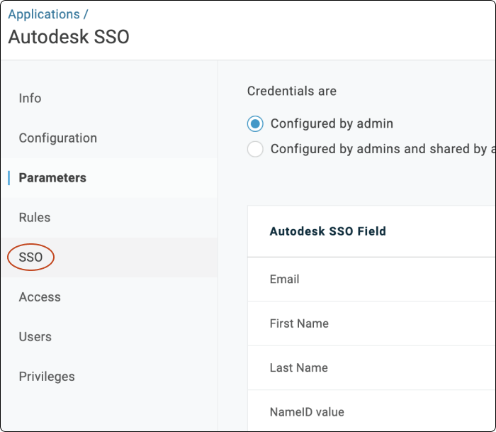

In the OneLogin portal, go to Applications > Autodesk SSO > SSO.
For automatic setup:
  1. Download the X.509 certificate generated by OneLogin.
  2. Click SSO.
    The default sign-on method is SAML 2.0.
  3. On the top-right corner, click More Actions > SAML Metadata to download the XML file.
  4. Switch to Autodesk Account, select Upload to upload the SAML Metadata file which you downloaded from OneLogin.
  5. Confirm that the fields are filled in and click Next.
For manual setup:
  1. Copy Issuer URL and SAML 2.0 Endpoint (HTTP) values.

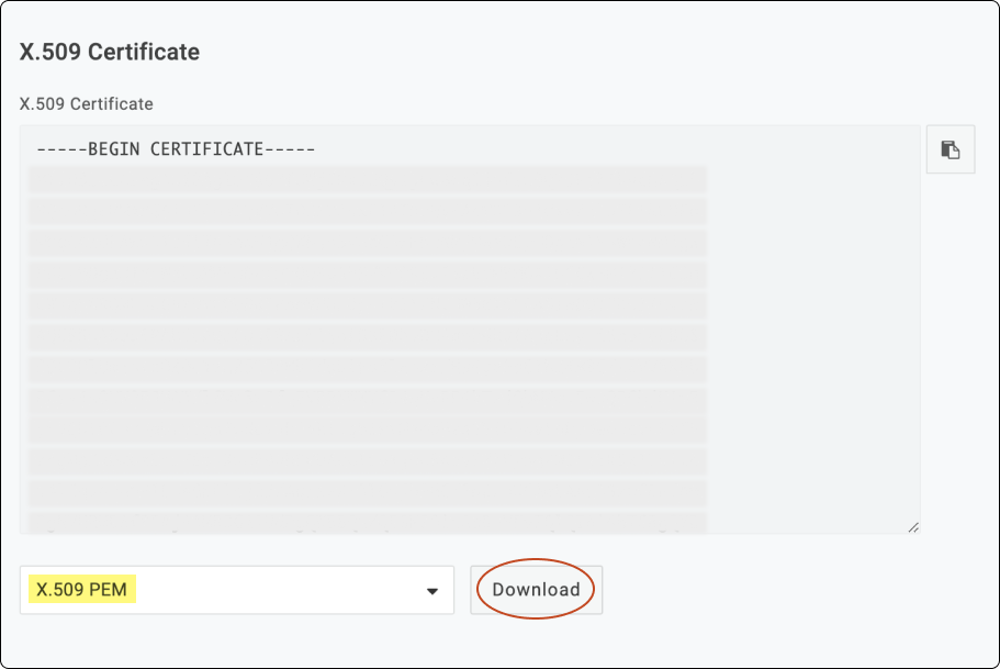

  2. Under SAML Signature algorithm select SHA-512 and click Save > View Details.
  3. Click Download to save the '.PEM' file.
  4. Enter the information you copied from OneLogin and paste into Autodesk as shown in the table.

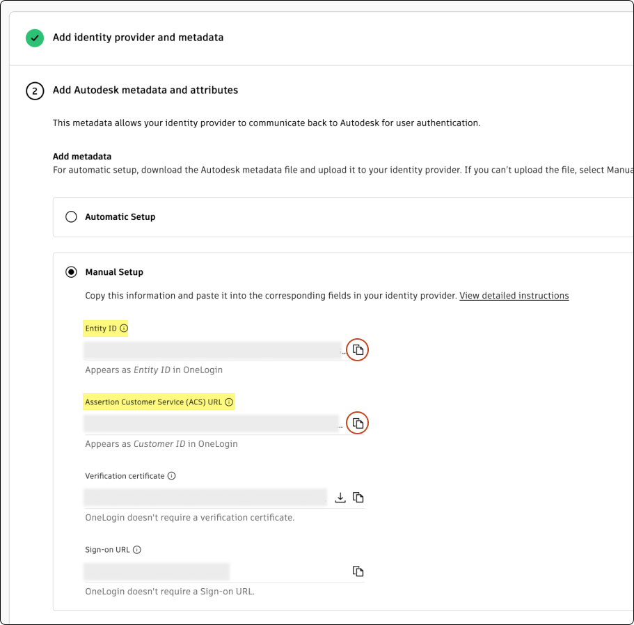

Add Autodesk metadata to OneLogin
This step allows Autodesk to complete the connection with your identity provider for user authentication.
  1. Select Manual setup. Note that you can only select Manual setup here because the OneLogin portal does not have an option to upload metadata file automatically.
  2. In Autodesk, copy the Entity ID and Assertion Customer Service (ACS) URL. OneLogin does not require the verification certificate so you can ignore this field.
  3. Return to OneLogin.
  4. Enter the information you copied from Autodesk and paste it into OneLogin as shown in the table.
    Autodesk OneLogin
    Entity ID Entity ID
    Assertion Customer Service (ACS) URL Customer ID

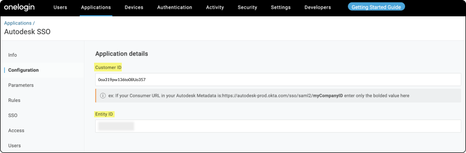

  5. In OneLogin Portal > Applications > Autodesk SSO > Configuration
  6. Under Customer ID, enter the company ID, which is usually the last part of the URL from the Location value you noted earlier. In the example https://dev-289038.okta.com/sso/saml2/0oa319pw136to08Uo357, the company ID is 0oa319pw136to08Uo357.
  7. Under Entity ID, enter the entityID value you noted earlier.
  8. Click Save.
