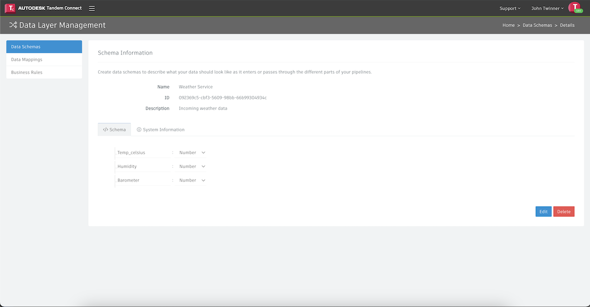

The first step in data mapping involves describing your data structure for both source and destination systems. Use the UI feature to describe data as a hierarchy and specify the data type for each property. In the example below, we've created a schema for incoming data from a Weather service that gives temperature in celsius. Suppose we want to send that data to Tandem, but with temperature in Farenheit. We make a schema for Tandem, map the data from one schema to the other, and supply a custom function to do the conversion from C to F.
schema

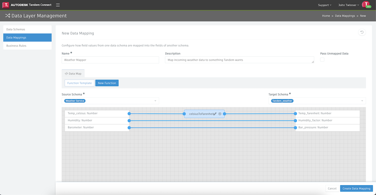

Once you have created both schemas, click on Data Mappings on the left panel and create a mapping by dragging a line from the source property to the destination property.
map-map

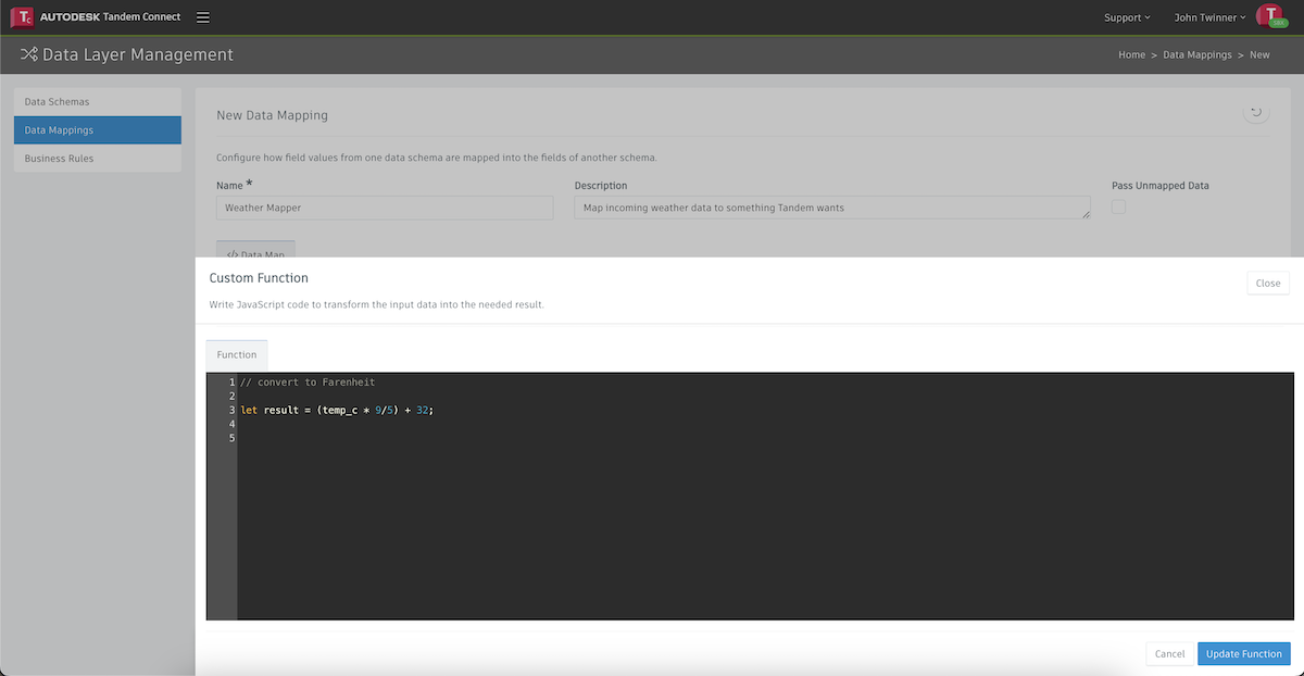

To add a custom function, click the New Function button and add some JavaScript code, as shown below.
map-func
