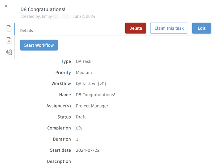

Start work on a task
When you're ready for work to begin on a task, you may start its workflow.
From the list of QA processes, select the task you want to begin working on.
Its detail view opens.
At the top of the detail view, click Start workflow. Alternatively, you may start a task within your CAD or Office plugin.
Once the workflow is started, the task's status changes to In Progress.
Claim a task
If the task has been assigned to a role or team, any member with that role on the project or member of that team may claim the task to begin working on it, but once claimed, that team member is the only one that can complete it.
To claim a task:
Its details view opens.
Click Claim this task.
The task is now assigned to you and you may begin working on the task.
