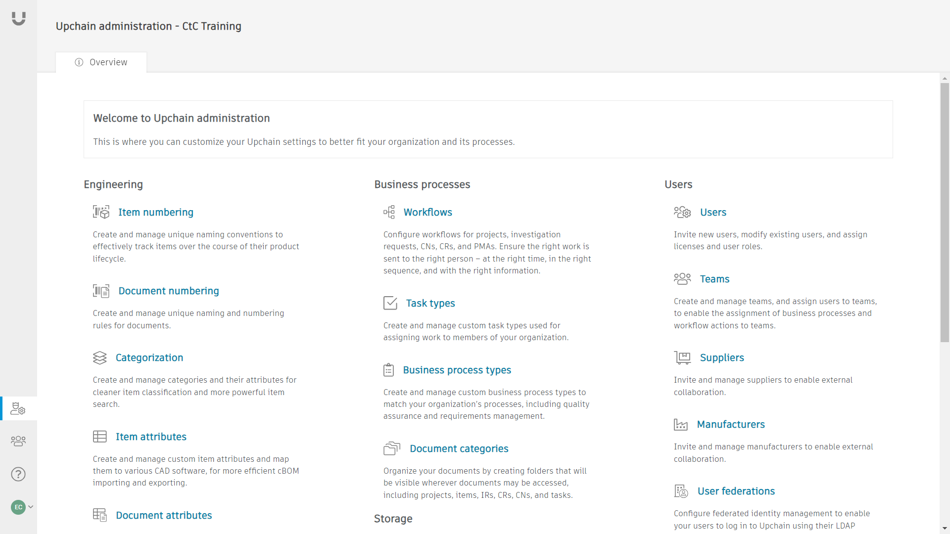

The Administration page is found under your Profile drop-down menu in the top-right corner of the main dashboard. To access it:
  1. Click the down arrow beside your profile image or initials.
  2. Select Administration from the menu.
Note: If you do not see Administration in this menu, then you do not have the role of Tenant Administrator assigned.
The Administration page opens.
Note: This image shows Upchain's new theme. Click the chevron next to your profile icon in the main dashboard to open the user menu and select Switch theme.
Administration page overview
The Administration page is organized into six sections:
