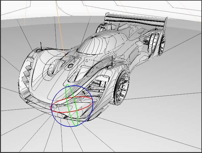

In Isophotes mode, a virtual light source provides defuse illumination to the object geometry. All points sharing the same brightness value are connected with a line.

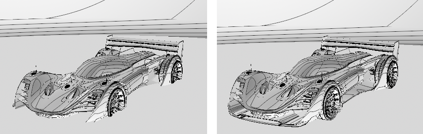

Surface Analysis Off Surface Analysis On - Isophotes Mode
Analysis Off Analysis On
  1. From the Analysis Mode box of the Surface Analysis dialog box, select Isophotes.
  2. To orient light direction along an axis, select X, Y, or Z beside Set to Axis (under Define Light Source).
  3. Select Show Light Direction to show the light direction manipulator.
  4. To define light direction using the surface normals on your geometry, click Pick Surface Normals, then Shift-drag the manipulator in the scene.
  5. To align the light along the camera vector, click Use Camera View Vector.
  6. Under Lines / Stripes, adjust the type, amount, and color of the lines.
