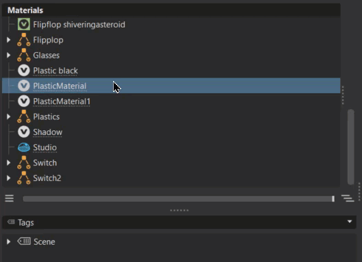

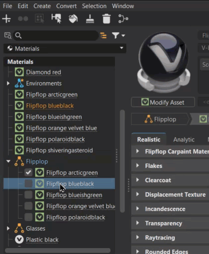

  • Select Nodes icon Select Nodes (Ctrl + N) - Selects the geometry nodes assigned to the currently selected materials.
  • Select Material icon Select Material - Selects the original material used in the grouped hierarchy (a switch, multi pass, or layered material). Select a child material within a switch, multi pass, or layered material, then right-click and choose Select Material to select the original material.
    Select Material example
  • Select all Occurances icon Select all Occurances - Selects all occurances of the selected underlined material, expanding group hierarchies and highlighting the parent text blue, to show where a material is used. Now, with one or more materials selected, use Select all Occurrences to select all examples of its or their use.
    Select all Occurances example
  • Select by Environment icon Select by Environment - Selects all materials with the same environment as the selected material in the Material Group or preview. Use it when there different environments used for different materials and you want to select all materials assigned to a specific environment.
    When one or more environments or environment switches is selected with this option, all materials in the Material Editor with this environment assignment are also selected.

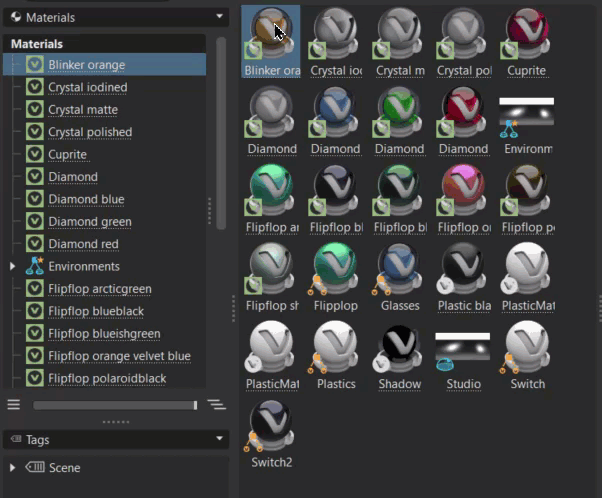

  • Scroll to Selection icon Scroll to Selection (Ctrl + Shift + F) - Scrolls to the selected material. This is useful when working with large lists of materials.

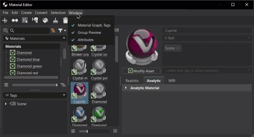

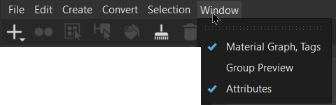

Window
Contains options for displaying one or more of these Material Editor components: Material Graph/Tags, Group Preview, and Attributes. When an option is checked, that component is displayed in the editor. When unchecked, it is removed.
All Components
