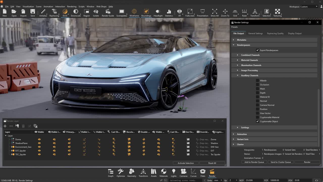

Video captions: Besides the introduction of Vulkan, we also added and improved more aspects around VRED’s Rendering capabilities. You can now create custom or user defined cryptomatte render passes via the render layer module. This allows a more granular control about the creation and assignment of masks for post processing workflows. The output will be a Multilayered EXR file where every layer contains a separate mask.

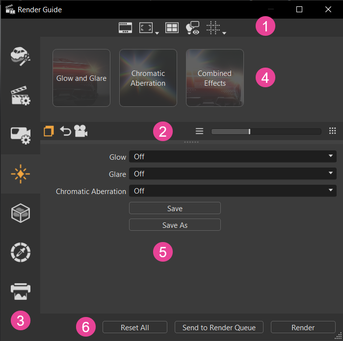

1 icon Main Toolbar
Tip:

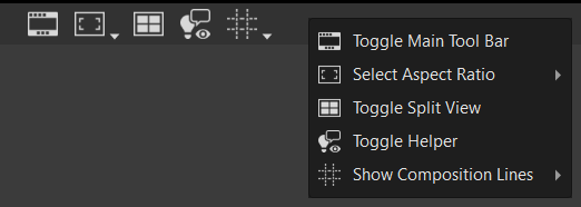

Right-click next to the main toolbar to access a context-menu of these tools.
Main toolbar context menu

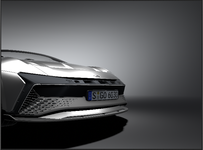

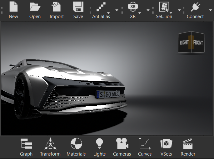

  • Toggle Main Toolbar icon Toggle Main Toolbar - Hides VRED toolbars to set up the viewport for a cleaner view of your scene when rendering. Click Toggle Main Toolbar icon again to display the main toolbar.
    Original Layout Using Toggle Main Toolbar
    Original Layout Toggle Main Toolbar used
  • Set Aspect Ratio icon Set Aspect Ratio - Defines the aspect ratio used in the viewport. Select from Dynamic Resolution 21:9, 4:3 Ratio, 16:9 Ratio, 2.39 Ratio, and Use Preferences, which uses whatever was set in your Render Settings > Image preferences.

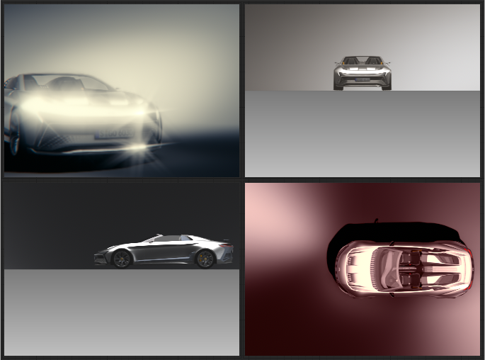

  • Show Split View icon Show Split View - Provides a layout to see four different angles in the viewport when rendering. Click Show Split View icon again to return to a single view.
    Tip:
    To apply a different color grading preset and/or effect to each view, click a view, then click a color grading preset, then an effect preset. Click the next view and select a different presets.
    All four camera views displayed

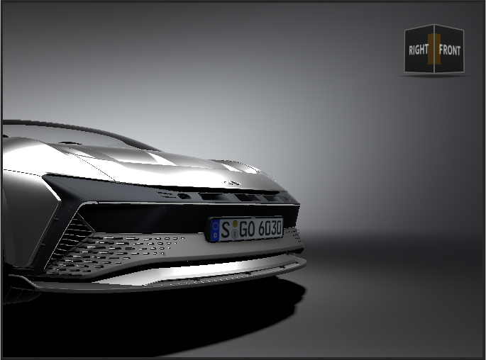

  • Show Helper icon Show Helper - Hides auxiliary UI, such as the View Cube, Navigation Bar, or visible cameras, that distract from the rendering. Click Show Helper icon again to return any auxiliary UI.
    Using Toggle Main Toolbar Using Show Helper
    Toggle Main Toolbar used Show Helper used

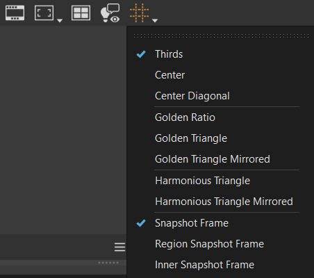

  • Composition Lines icon Composition Lines - Displays composition lines in the viewport. Use these when trying to compose a scene and place an object in the perfect spot to make the composition of the rendering more visually appealing and artistic. The composition lines change as the aspect ratio (Set Aspect Ratio icon) is changed.
    Viewport with composition lines displayed
    Click-hold Chevron icon for opening a cascading menu to access a menu where you can select one or more of the options to set up your composite lines.
    Composition Lines menu
    Click Composition Lines icon again to hide the composition lines in the viewport.
2 icon Splitter Bar
The tools in this bar are used for the following:
  • Show Properties icon - Each category has content-specific properties listed below the presets that are displayed by default. To show or hide these properties, click Show Properties icon. Use these properties to tweak your rendered image to achieve the look you want.
  • Reset icon - Resets the properties to the scene or file defaults.

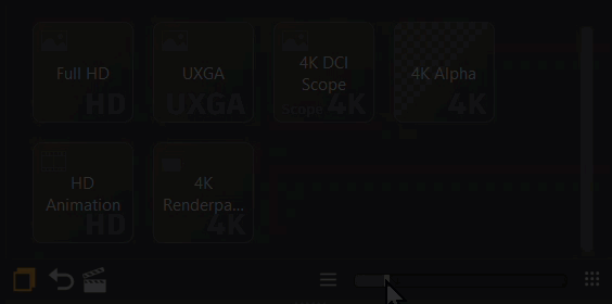

Use the slider and its buttons to quickly resize the presets displayed above the bar.
Changing the size of content displayed in the pane use the slider and buttons
3 icon Categories
Along the left of the guide are categories for accessing workflow-driven presets and their properties. Use them as a guide and go through each category, moving from one to the next and back. Start from top with Cinematic Settings and work your through Render Settings, Camera Settings, Effects, Volume Fog, Color Grading, and Render Output, quickly creating a rendered cinematic moody image.
4 icon Presets
Find presets for each category are found in this area. Presets were created with the beginner user in mind. These help to quickly achieve the look you want with minimal effort and without requiring expert knowledge.
To further refine the look, use the options in the Properties section. If access to additional settings is required, use the Render Settings icon Render Settings and Camera Editor icon Camera Editor quick access buttons in the Splitter Bar to open these editors for further options.
When a preset appears with a yellow border and icon, this indicates a change to its properties and just serves as a visual cue of changes, not an error.

5 icon Properties
Click Show Properties icon to display or hide the properties for a preset. Click one of the following links for information on the properties for that category.
6 icon Render Options
Once all changes are made within the guide, use one of these buttons at the bottom of the module to start image calculations.
  • Reset All - Resets all the categories. The reset values are updated when loading a project or when creating a new scene.
  • Send to Render Queue - Opens a file browser to name and set the location of the saved renderings, then opens the Render Queue, where the image names cannot be changed. Use the buttons along the bottom to send all renders to the Cluster Queue, add them to the Render Queue, or render all. See To Start Image Calculations for more details.
  • Render - Opens a file browser to name and setting the location of the saved renderings, then creates the image or movie at that location using the current settings. An image's name can be changed during this process.
