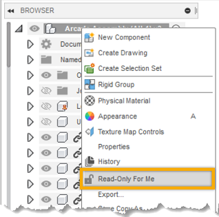

- In Fusion, with the design open, in the Browser, right-click the default component.
- Select Read-Only For Me.

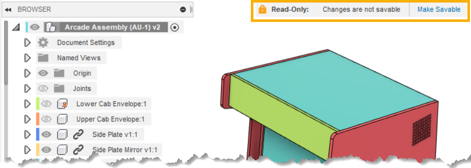

The design is read-only for you, and the Read-Only menu displays at the top of the canvas. You can navigate, view, analyze, or experiment with the design without reserving it and blocking access for other project members.

Once you're back at your computer where Fusion has the design open, you'll see the Read-Only menu at the top of the canvas, indicating the design is read-only for you.

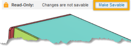

If you need to save your changes after all, in the design that you've made read-only for yourself, do one of the following:
- In the Read-Only menu at the top of the canvas, click Make Savable.
- In the Browser, right-click the default component, then select Read-Only For Me.
- Close the design.
The design is no longer read-only for you. If you made any changes while the design was read-only for you, Fusion will reserve the design for you if it isn't currently reserved by another project member.
