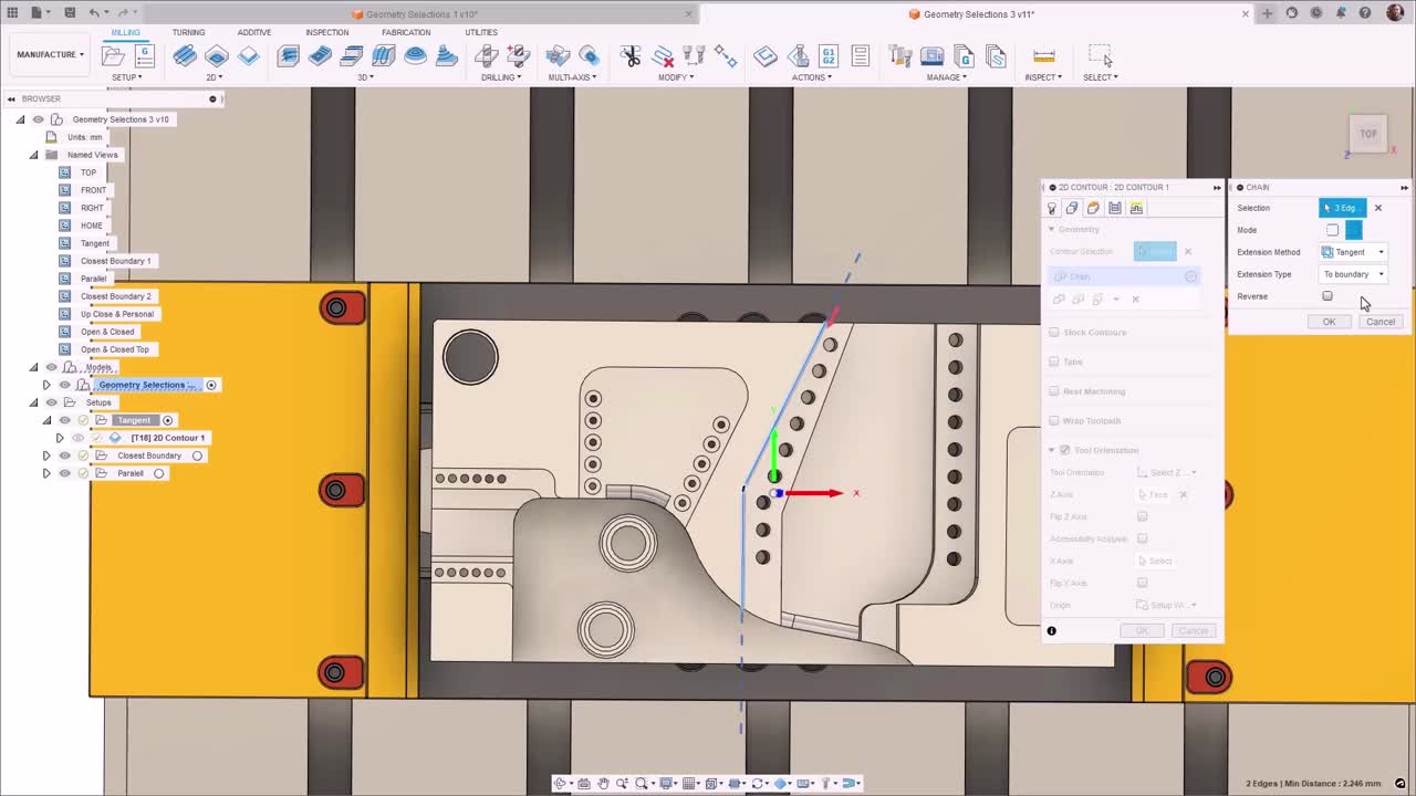

Open chain
An open chain can give you more control to target specific geometry.
Open contour example
Open chain selection
When selecting an open chain, you get extra controls of a Start Extension Length and End Extension Length to extend the geometry, which can be helpful depending on the type of geometry you are machining.
Extension length
