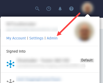

  1. In the Fusion web client, click the User Profile button User Glyph in the upper right of the hub.
  2. Click Admin.
    Click Admin

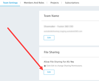

  3. Click Edit in the File Sharing panel.
    File share edit
  4. Set Allow File Sharing For All to the desired setting, on or off.
