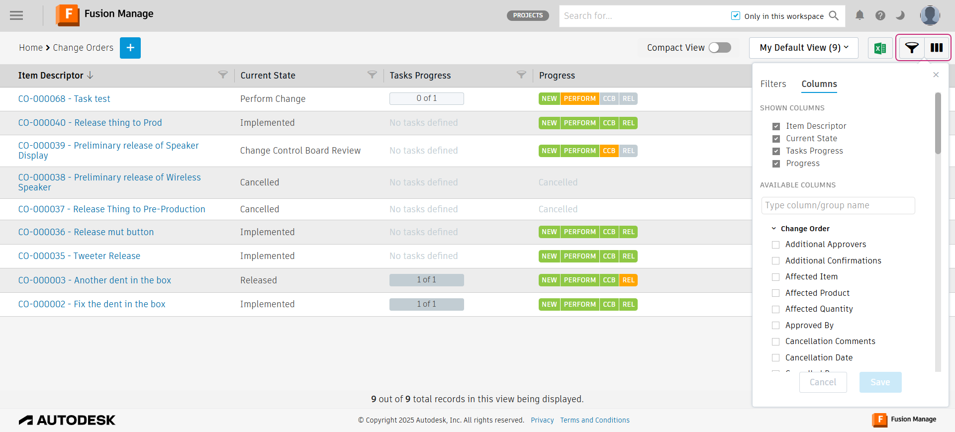

You can create custom views for each workspace by specifying the fields to show in the item list and applying filters. The filtered results can also be exported to an Excel spreadsheet.
Note: The custom views will need to be setup by every user as per their preference and currently these views cannot be shared across all users.
Recommendations
  • Refer to Work with custom views to learn more on how to create custom views.
  • As an example, you may want to include the Progress information as a visual way to track each change order.
    custom view

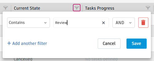

    After adding the required columns to the view, click the filter icon on any column heading to then filter the table by a specific value.

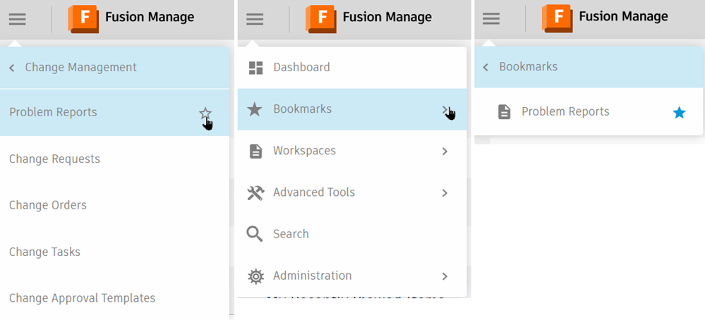

There may be specific workspaces that you will often visit. You can bookmark them to access them quicker.
In the Navigation menu, locate a workspace you want to bookmark, then click the star icon. You can then find your bookmarked workspaces in a dedicated Bookmarks section of the Navigation menu.
bookmark workspace
