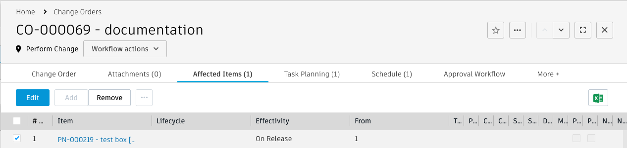

Removing an item from the Affected Items tab does not delete the item. The item is just no longer associated with the change order.
  1. In a change order, click the Affected Items tab.
  2. Select the items to remove.
    selected item
  3. Click Remove, then click Confirm.
    The selected items are removed from the Affected Items tab.
