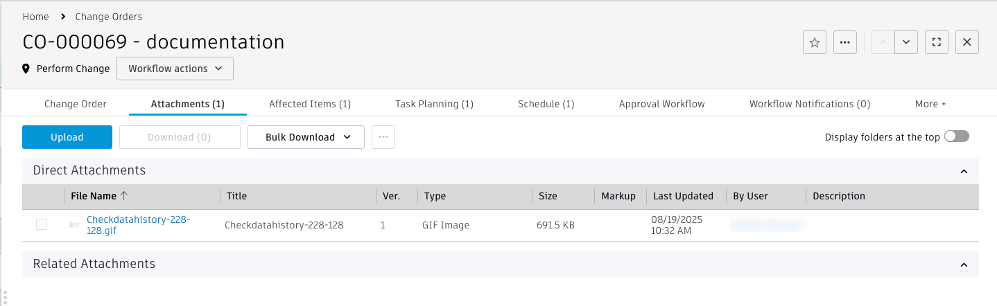

  1. On a change order, click the Attachments tab.
    attachments tab
  2. Click Upload.
  3. Select the files to upload and click Open.
  4. In the Upload dialog, for each file:
    • Enter a title.
      By default, the file name is used. Changing the title does not rename the file.
    • Enter a description.
    • If you want to organize the files into folders, select an existing folder or create a new one in the Upload to drop-down.
  5. If you need to add more files to the upload, click Add more files at the bottom of the dialog.
  6. Click Upload.
