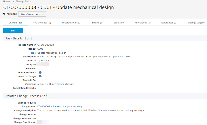

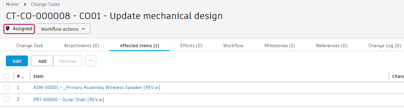

  1. Locate and review your first task: CT-<CO number>-CO01-Update mechanical design.

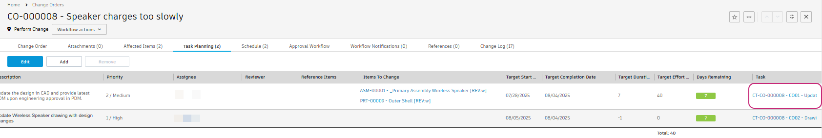

    • Option 1: Open the change order > Task Planning tab and click the task link in the far-right column.
      task link task planning tab

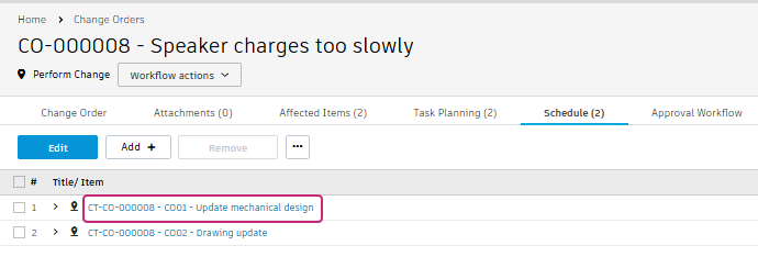

    • Option 2: Open the change order > Schedule tab and click the task in the table.
      tasks in schedule tab
    • Option 3: Open the main dashboard and locate the task in your My Outstanding Work list.
      tasks in My Outstanding Work
      Note: The first task CT-<CO number>-CO01-Update mechanical design is automatically put into the Assigned state. The second task CT-<CO number>-CO02-Drawing update is put into the Planned state because it depends on the first task being complete first.
  2. Explore the information that has been entered into the task.
    • Notice that this task is in the Assigned state because it was generated from a change order and already had an assignee (you).
    • Review the information in each section of the main tab.
      review change task tab
      review change task affected items tab

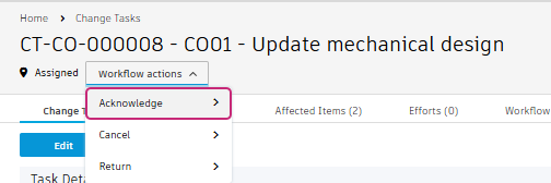

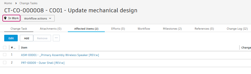

    1. Click the Workflow Actions drop-down and select Acknowledge.
      click acknowledge workflow action
      The task is now in the In Work state.
      change task in work state
    2. From the Affected Items tab of the task, click the link to the Wireless Speaker item.

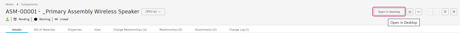

    3. From the item's page, click Open in Desktop in the top-right corner.
      wireless speaker open in desktop
      The item is opened into the Fusion desktop client.

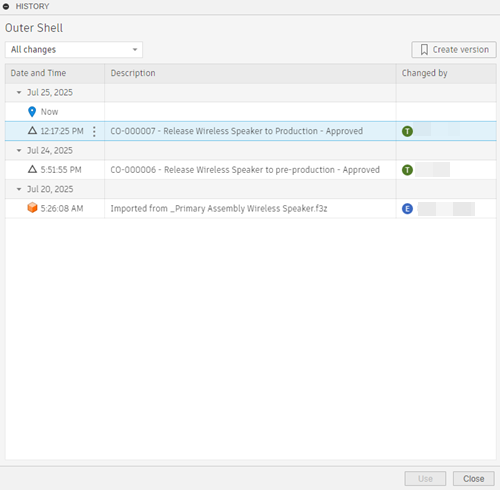

  4. Review the history and the properties for the Wireless Speaker and the Outer Shell components.

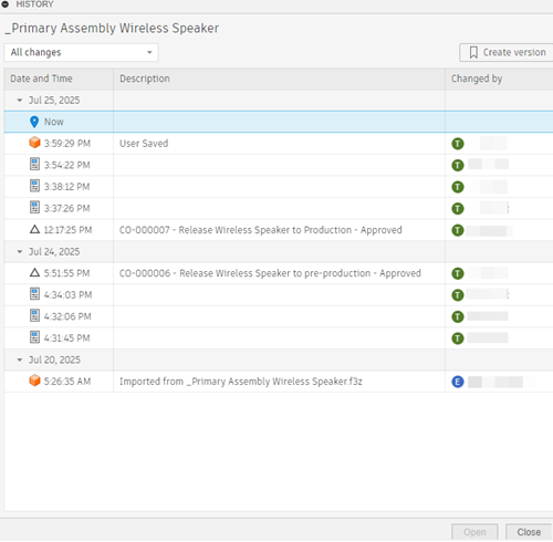

    • Open the history for the Wireless Speaker. Notice that the first revision is now historical (white triangle).
      wireless speaker open history

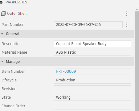

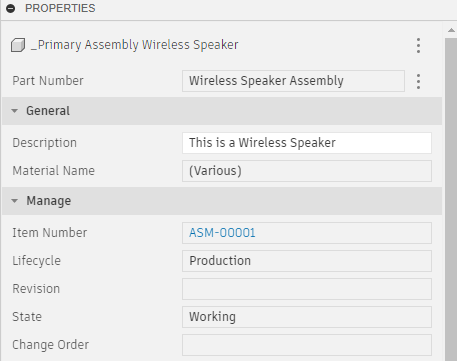

    • Open the properties and notice the state has moved to Working.
      wireless speaker working state
    • The same should be true for the Outer Shell.
      outer shell open history
      outer shell working state

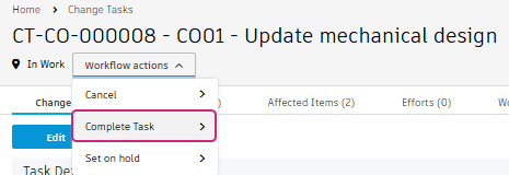

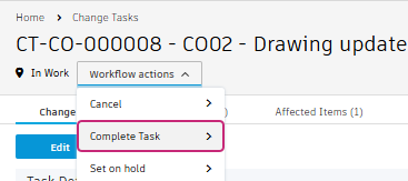

  5. In the Fusion Manage Extension site, mark the task as complete.
    • Option 1: from the Workflow tab, click the Complete Task transition and enter any comments.
    • Option 2: From the Workflow Actions drop-down, select Complete Task and enter any comments.
      complete first task
      Note: Workflow action comments are stored in the Comments Log in the Workflow Comments History section of the Change Task tab.

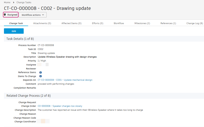

    1. Notice this task is now in the Assigned state because it depended on task CO01, which is now complete.
      second task in assigned state

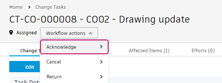

    2. Click the Workflow Actions drop-down and select Acknowledge.
      click acknowledge workflow action second task

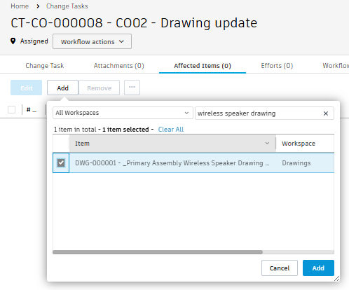

    3. From the Affected Items tab of the task, add the Wireless Speaker drawing. Click Add and select the drawing.
      add wireless speaker drawing to affected item task

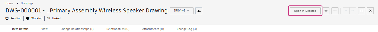

    4. From the Affected Items tab of the task, click the link to the Wireless Speaker drawing item.
    5. From the item's page, click Open in Desktop in the top-right corner.
      wireless speaker drawing open in desktop
      The drawing is opened into the Fusion desktop client.

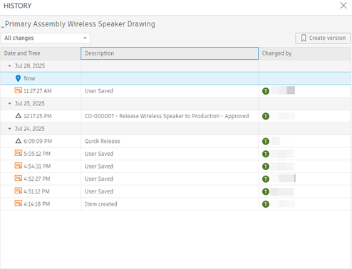

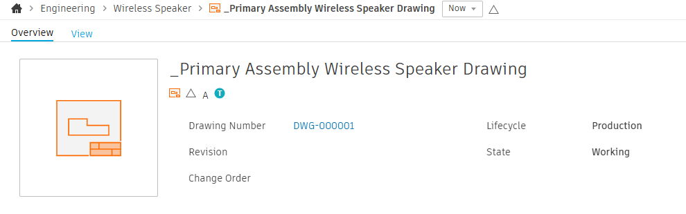

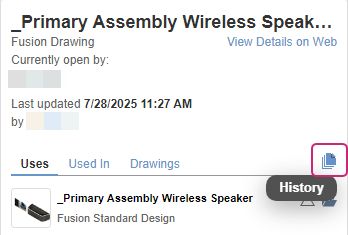

    7. Open the history for the Wireless Speaker drawing. Again, notice that the revision is now historical (white triangle) and the state is Working.
      wireless speaker drawing click history
      wireless speaker drawing white triangle history
      wireless speaker drawing working state
    8. In the Fusion Manage Extension site, mark the task as complete.
      wireless speaker drawing complete second task

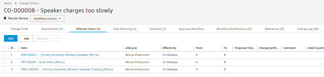

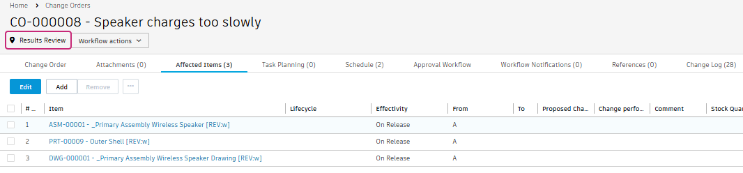

  7. Notice the change order has now automatically transitioned to the Results Review state since all the tasks have been completed. Notice as well that the additional items added to each task have now been added to the Affected Items tab of the change order.
    change order affected item updated with additional item

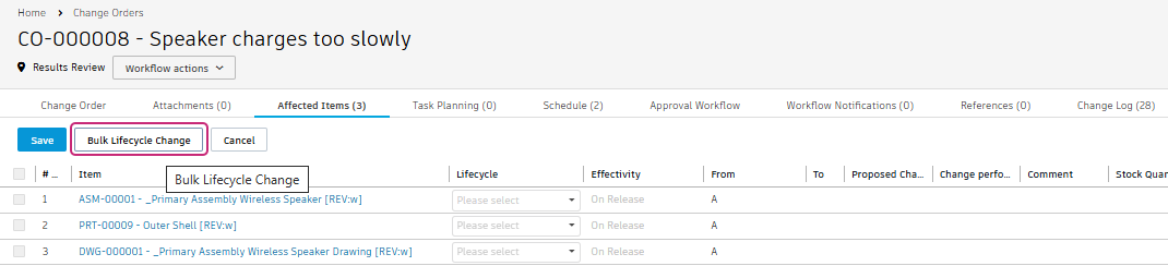

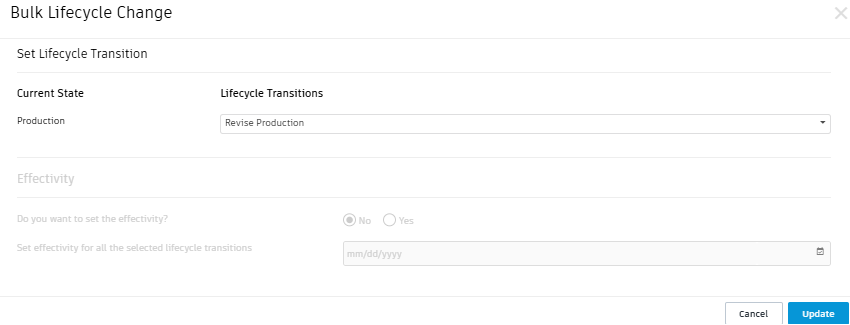

  8. Set the lifecycle to Revise Production for all items.
    1. Click Edit.
    2. Click Bulk Lifecycle Change.
      change order click bulk lifecycle change
    3. From the drop-down, select Revise Production.
      change order click bulk lifecycle set revise to production
    4. Click Update.
    5. Click Save.
      change order click bulk lifecycle set revise to production update and save

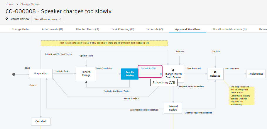

  9. Send the change order for review by the CCB.
    • Option 1: From the Workflow tab, click the Submit to CCB transition.
    • Option 2: From the Workflow Actions drop-down, select Submit to CCB.
      change order click submit to CCB workflow transition
      This sends the CO to the Change Control Board Review state where the change control board reviews the design changes you made and determines if the items can be released.
