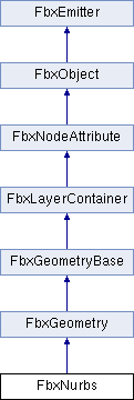

Inheritance diagram for FbxNurbs:Public Member Functions | |
