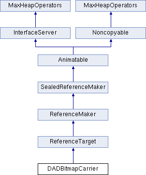

+ Inheritance diagram for DADBitmapCarrier:
