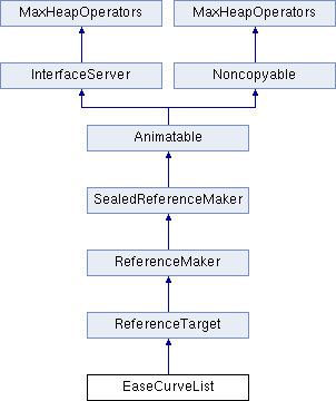

+ Inheritance diagram for EaseCurveList:
