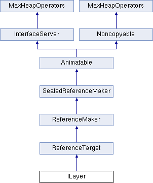

| virtual SClass_ID | SuperClassID () |
| | Retrieves a constant representing the type of the plugin. More...
| virtual void | SetName (const MSTR &name)=0 |
| virtual MSTR | GetName () const =0 |
| virtual void | SetWireColor (DWORD newcol, bool propagate=false)=0 |
| virtual DWORD | GetWireColor () const =0 |
| virtual void | Hide (bool onOff, bool propagate=false)=0 |
| virtual bool | IsHidden () const =0 |
| virtual void | Freeze (bool onOff, bool propagate=false)=0 |
| virtual bool | IsFrozen () const =0 |
| virtual void | XRayMtl (bool onOff, bool propagate=false)=0 |
| virtual bool | HasXRayMtl () const =0 |
| virtual void | BoxMode (bool onOff, bool propagate=false)=0 |
| virtual bool | GetBoxMode () const =0 |
| virtual void | BackCull (bool onOff, bool propagate=false)=0 |
| virtual bool | GetBackCull () const =0 |
| virtual void | AllEdges (bool onOff, bool propagate=false)=0 |
| virtual bool | GetAllEdges () const =0 |
| virtual void | VertTicks (bool onOff, bool propagate=false)=0 |
| virtual bool | GetVertTicks () const =0 |
| virtual void | Trajectory (bool onOff, bool propagate=false)=0 |
| virtual bool | GetTrajectory () const =0 |
| virtual void | IgnoreExtents (bool onOff, bool propagate=false)=0 |
| virtual bool | GetIgnoreExtents () const =0 |
| virtual void | SetShowFrozenWithMtl (bool onOff, bool propagate=false)=0 |
| virtual bool | ShowFrozenWithMtl () const =0 |
| virtual void | SetCVertMode (bool onOff, bool propagate=false)=0 |
| virtual bool | GetCVertMode () const =0 |
| virtual void | SetShadeCVerts (bool onOff)=0 |
| virtual bool | GetShadeCVerts () const =0 |
| virtual void | SetVisibility (TimeValue t, float vis)=0 |
| virtual float | GetVisibility (TimeValue t, Interval *valid=NULL) const =0 |
| virtual float | GetVisibility (TimeValue t, View &view, Interval *valid=NULL) const =0 |
| virtual float | GetLocalVisibility (TimeValue t, Interval *valid) const =0 |
| virtual bool | IsHiddenByVisControl ()=0 |
| virtual void | SetRenderable (bool onOff, bool propagate=false)=0 |
| virtual bool | Renderable () const =0 |
| virtual void | SetInheritVisibility (bool onOff)=0 |
| virtual bool | GetInheritVisibility () const =0 |
| virtual void | SetPrimaryVisibility (bool onOff)=0 |
| virtual bool | GetPrimaryVisibility () const =0 |
| virtual void | SetSecondaryVisibility (bool onOff)=0 |
| virtual bool | GetSecondaryVisibility () const =0 |
| virtual void | SetCastShadows (bool onOff)=0 |
| virtual bool | CastShadows () const =0 |
| virtual void | SetRcvShadows (bool onOff)=0 |
| virtual bool | RcvShadows () const =0 |
| virtual void | SetApplyAtmospherics (bool onOff)=0 |
| virtual bool | ApplyAtmospherics () const =0 |
| virtual void | SetRenderOccluded (bool onOff)=0 |
| virtual int | GetRenderOccluded () const =0 |
| virtual bool | GetMotBlurOnOff (TimeValue t) const =0 |
| virtual void | SetMotBlurOnOff (TimeValue t, bool onOff)=0 |
| virtual float | GetImageBlurMultiplier (TimeValue t) const =0 |
| virtual void | SetImageBlurMultiplier (TimeValue t, float m)=0 |
| virtual void | SetMotBlur (int kind)=0 |
| virtual int | MotBlur () const =0 |
| virtual void | SetDisplayByLayer (BOOL onOff, INode *)=0 |
| virtual void | SetRenderByLayer (BOOL onOff, INode *)=0 |
| virtual void | SetMotionByLayer (BOOL onOff, INode *)=0 |
| virtual BOOL | GetDisplayByLayer (INode *) const =0 |
| virtual BOOL | GetRenderByLayer (INode *) const =0 |
| virtual BOOL | GetMotionByLayer (INode *) const =0 |
| virtual bool | AddToLayer (INode *node)=0 |
| virtual bool | DeleteFromLayer (INode *rtarg)=0 |
| virtual bool | Used (void) const =0 |
| virtual bool | HasObjects () const =0 |
| virtual void | SelectObjects (void)=0 |
| virtual ILayer * | GetParentLayer () const =0 |
| virtual bool | SetParentLayer (ILayer *parentLayer)=0 |
| virtual ILayer * | GetChildLayer (int n) const =0 |
| virtual int | GetNumOfChildLayers () const =0 |
| virtual int | GetRenderFlags () const =0 |
| virtual void | SetRenderFlags (int flags)=0 |
| virtual int | GetDisplayFlags () const =0 |
| virtual bool | GetFlag (int mask) const =0 |
| virtual bool | GetFlag2 (int mask) const =0 |
| virtual void | UpdateSelectionSet (void)=0 |
| virtual int | GetRenderFlags (int oldlimits) const =0 |
| virtual CoreExport void | GetClassName (MSTR &s) |
| | Retrieves the name of the plugin class. More...
| virtual BOOL | IsRefTarget () |
| | Checks if this is a ReferenceTarget. More...
| CoreExport RefResult | TestForLoop (const Interval &refInterval, RefMakerHandle hmaker) |
| | Tests for a cyclical reference. More...
| CoreExport BOOL | HasDependents () |
| | Checks if a ReferenceTarget has references. More...
| CoreExport BOOL | HasRealDependents () |
| | Checks if this has Real (Strong) Dependents. More...
| void | BeginDependencyTest () |
| | Starts Dependency Test. More...
| BOOL | EndDependencyTest () |
| | Ends Dependency Test. More...
| virtual void | RefAdded (RefMakerHandle rm) |
| | Called after a reference is made to a target. More...
| virtual void | RefAddedUndoRedo (RefMakerHandle rm) |
| | Called after a reference is made to a target because of undo or redo. More...
| virtual void | RefDeleted () |
| | Called after a references to this is deleted. More...
| virtual void | RefDeletedUndoRedo () |
| | Called after a references to this is deleted because of undo or redo. More...
| CoreExport RefResult | DeleteAllRefsToMe () |
| | Deletes all references to this ReferenceTarget. More...
| CoreExport RefResult | TransferReferences (RefTargetHandle oldTarget, BOOL delOld=FALSE) |
| | Transfers all the references from oldTarget to this. More...
| CoreExport int | DoEnumDependents (DependentEnumProc *dep) |
| | Begins an enumeration that searches back in the dependency network. More...
| virtual CoreExport RefTargetHandle | Clone (RemapDir &remap) |
| | This method is used by 3ds Max to clone an object. More...
| virtual CoreExport void | BaseClone (ReferenceTarget *from, ReferenceTarget *to, RemapDir &remap) |
| | This method copies base class data from an object to its clone. More...
| virtual CoreExport RefResult | NotifyDependents (const Interval &changeInt, PartID partID, RefMessage message, SClass_ID sclass=NOTIFY_ALL, BOOL propagate=TRUE, RefTargetHandle hTarg=NULL) |
| | Notify all dependent RefMakers concerned with the message. More...
| void | FlagDependents (TimeValue t, PartID which=PART_PUT_IN_FG) |
| | This sends the REFMSG_FLAGDEPENDENTS message up the pipeline. More...
| virtual void | NotifyForeground (TimeValue t) |
| | This method is called to flag dependents into the FG. More...
| virtual void | NotifyTarget (int message, ReferenceMaker *hMaker) |
| | Sends messages to ReferenceTargets. More...
| virtual CoreExport void * | GetInterface (ULONG id) |
| | Inherited from Animatable. More...
| virtual CoreExport BaseInterface * | GetInterface (Interface_ID id) |
| CoreExport | ReferenceTarget () |
| | Constructor. More...
| virtual CoreExport RefResult | AutoDelete () |
| | Deletes the object when it has no more real dependents. More...
| CoreExport RefResult | MaybeAutoDelete () |
| CoreExport RefResult | ReplaceReference (int which, RefTargetHandle newtarg, BOOL delOld=TRUE) |
| | Used when cloning reference makers. More...
| CoreExport RefResult | DeleteAllRefsFromMe () |
| | Deletes all references from this ReferenceMaker. More...
| CoreExport RefResult | DeleteAllRefs () |
| | Deletes all references both to and from this item. More...
| CoreExport RefResult | DeleteReference (int i) |
| | Deletes the specified reference. More...
| virtual BOOL | CanTransferReference (int i) |
| | Tells whether this reference can be transfered. More...
| CoreExport ReferenceSaveManager & | GetReferenceSaveManager () |
| | Access the ReferenceSaveManager of this ReferenceMaker. More...
| virtual CoreExport IOResult | Save (ISave *isave) |
| | Called for saving data. More...
| virtual CoreExport IOResult | Load (ILoad *iload) |
| | Called for loading data. More...
| virtual int | RemapRefOnLoad (int iref) |
| | Used to load old files with references. More...
| virtual CoreExport void | RescaleWorldUnits (float f) |
| | Rescale size of all world units in reference hierarchy. More...
| virtual CoreExport void | EnumAuxFiles (AssetEnumCallback &assetEnum, DWORD flags) |
| | Enumerate auxiliary files (e.g. bitmaps) More...
| virtual CoreExport void | SaveEnum (SaveEnumProc &sep, BOOL isNodeCall=0) |
| | The default save enumeration. More...
| virtual CoreExport bool | SpecifySaveReferences (ReferenceSaveManager &referenceSaveManager) |
| | Used to specify reference slot remapping during scene file save. More...
| CoreExport bool | EnumRefHierarchy (RefEnumProc &proc, bool includeCustAttribs=true, bool includeIndirectRefs=true, bool includeNonPersistentRefs=true, bool preventDuplicatesViaFlag=true) |
| | This method provides a general purpose reference enumerator. More...
| CoreExport int | FindRef (RefTargetHandle rtarg) |
| | Get the index of the ReferenceTarget. More...
| virtual BOOL | IsRefMaker () |
| | Tells whether it is a ReferenceMaker. More...
| virtual BOOL | IsRealDependency (ReferenceTarget *rtarg) |
| | Returns whether this is a "real" (strong) dependency or not. More...
| virtual BOOL | ShouldPersistWeakRef (RefTargetHandle rtarg) |
| | Specifies whether a weak reference is to be persisted on a partial load or save. More...
| CoreExport | ReferenceMaker () |
| CoreExport void | DeleteMe () |
| | Deletes an instance of this class. More...
| virtual CoreExport int | NumRefs () |
| | Returns the total number of references this ReferenceMaker can hold. More...
| virtual CoreExport RefTargetHandle | GetReference (int i) |
| | Returns the 'i-th' reference. More...
| void | SetAFlag (DWORD mask) |
| | Sets one or more bits in the Animatable flags. More...
| void | ClearAFlag (DWORD mask) |
| | Clears one or more bits in the Animatable flags. More...
| BOOL | TestAFlag (DWORD mask) |
| | Tests one or more bits in the Animatable flags. More...
| void | SetAFlagEx (DWORD mask) |
| | Sets one or more bits in the Animatable extended flags. More...
| void | ClearAFlagEx (DWORD mask) |
| | Clears one or more bits in the Animatable extended flags. More...
| BOOL | TestAFlagEx (DWORD mask) |
| | Tests one or more bits in the Animatable extended flags. More...
