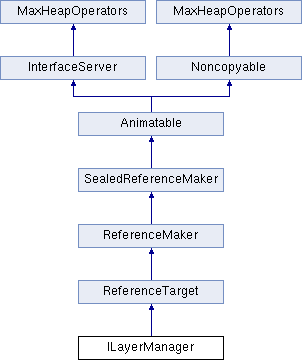

| SClass_ID | SuperClassID () |
| | Retrieves a constant representing the type of the plugin. More...
| virtual bool | AddLayer (ILayer *layer)=0 |
| virtual ILayer * | CreateLayer (void)=0 |
| virtual ILayer * | CreateLayer (MSTR &name)=0 |
| virtual BOOL | DeleteLayer (const MSTR &name)=0 |
| virtual void | SetCurrentLayer (const MSTR &name)=0 |
| virtual void | SetCurrentLayer (void)=0 |
| virtual ILayer * | GetCurrentLayer (void) const =0 |
| virtual void | EditLayer (const MSTR &name)=0 |
| virtual void | DoLayerPropDialog (HWND hWnd)=0 |
| virtual int | GetLayerCount (void)=0 |
| virtual ILayer * | GetLayer (int) const =0 |
| | Gets the specified layer by index. More...
| virtual ILayer * | GetLayer (const MSTR &name) const =0 |
| virtual void | SetupToolList2 (HWND hWnd, HWND hParent)=0 |
| virtual MSTR | GetSavedLayer (int i) const =0 |
| virtual ILayer * | GetRootLayer () const =0 |
| virtual void | Reset (BOOL fileReset=FALSE)=0 |
| virtual void | SetPropagateToLayer (int prop)=0 |
| virtual int | GetPropagateToLayer (void)=0 |
| virtual CoreExport void | GetClassName (MSTR &s) |
| | Retrieves the name of the plugin class. More...
