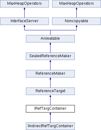

+ Inheritance diagram for IRefTargContainer:
