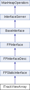

| virtual int | GetNumAvailableTrackViews () |
| virtual ITreeViewOps * | GetTrackView (int index) |
| virtual ITreeViewOps * | GetTrackView (MSTR name) |
| virtual Tab< ITreeViewOps * > | GetAvaliableTrackViews () |
| virtual ITreeViewOps * | GetLastActiveTrackView () |
| virtual BOOL | IsTrackViewOpen (MSTR name) |
| virtual BOOL | IsTrackViewOpen (int index) |
| virtual BOOL | OpenTrackViewWindow (MSTR name, MSTR layoutName=_M(""), Point2 pos=Point2(-1.0f,-1.0f), int width=-1, int height=-1, int dock=TV_FLOAT) |
| virtual BOOL | OpenTrackViewWindow (int index) |
| virtual BOOL | OpenLastActiveTrackViewWindow () |
| virtual BOOL | CloseTrackView (MSTR name) |
| virtual BOOL | CloseTrackView (int index) |
| virtual BOOL | DeleteTrackView (MSTR name) |
| virtual BOOL | DeleteTrackView (int index) |
| virtual const MCHAR * | GetTrackViewName (int index) |
| virtual const MCHAR * | GetLastUsedTrackViewName () |
| virtual BOOL | IsTrackViewCurrent (int index) |
| virtual BOOL | IsTrackViewCurrent (MSTR name) |
| virtual BOOL | SetTrackViewCurrent (int index) |
| virtual BOOL | SetTrackViewCurrent (MSTR name) |
| virtual BOOL | TrackViewZoomSelected (MSTR tvName) |
| virtual BOOL | TrackViewZoomOn (MSTR tvName, Animatable *anim, int subNum) |
| | DECLARE_DESCRIPTOR (ITrackViewArray) |
| BEGIN_FUNCTION_MAP | FN_1 (getTrackView, TYPE_INTERFACE, fpGetTrackView, TYPE_FPVALUE) |
| | FN_0 (getAvaliableTrackViews, TYPE_INTERFACE_TAB_BV, GetAvaliableTrackViews) |
| | FN_0 (getNumAvailableTrackViews, TYPE_INT, GetNumAvailableTrackViews) |
| | FN_6 (openTrackView, TYPE_BOOL, fpOpenTrackViewWindow, TYPE_FPVALUE, TYPE_TSTR_BV, TYPE_POINT2_BV, TYPE_INT, TYPE_INT, TYPE_ENUM) |
| | FN_1 (closeTrackView, TYPE_BOOL, fpCloseTrackView, TYPE_FPVALUE) |
| | VFN_1 (deleteTrackView, fpDeleteTrackView, TYPE_FPVALUE) |
| | FN_1 (getTrackViewName, TYPE_STRING, GetTrackViewName, TYPE_INDEX) |
| | FN_1 (trackViewZoomSelected, TYPE_BOOL, TrackViewZoomSelected, TYPE_TSTR) |
| | FN_3 (trackViewZoomOn, TYPE_BOOL, fpTrackViewZoomOn, TYPE_TSTR, TYPE_REFTARG, TYPE_INDEX) |
| | FN_VA (setFilter, TYPE_BOOL, fpSetTrackViewFilter) |
| | FN_VA (clearFilter, TYPE_BOOL, fpClearTrackViewFilter) |
| | FN_VA (pickTrackDlg, TYPE_FPVALUE_BV, fpDoPickTrackDlg) |
| | FN_1 (isOpen, TYPE_BOOL, fpIsTrackViewOpen, TYPE_FPVALUE) |
| | FN_0 (openLastTrackView, TYPE_BOOL, OpenLastActiveTrackViewWindow) |
| | RO_PROP_FN (currentTrackViewProp, GetLastActiveTrackView, TYPE_INTERFACE) |
| | RO_PROP_FN (lastUsedTrackViewNameProp, GetLastUsedTrackViewName, TYPE_STRING) |
| | FN_1 (isTrackViewCurrent, TYPE_BOOL, fpIsTrackViewCurrent, TYPE_FPVALUE) |
| | FN_1 (setTrackViewCurrent, TYPE_BOOL, fpSetTrackViewCurrent, TYPE_FPVALUE) |
| | FN_1 (doesTrackViewExist, TYPE_BOOL, fpDoesTrackViewExist, TYPE_FPVALUE) |
