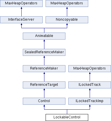

This reference page is linked to from the following overview topics: #include <ILockedTracks.h>
Inheritance diagram for LockableControl:Public Member Functions | |
