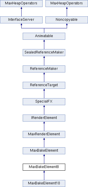

#include <renderelements.h>
Extention to MaxBakeElement in 3ds Max 8.
Extends MaxBakeElement, allowing Texture Bake Elements to provide parameters of integer, float, and color types in addition to booleans. The RTT dialog is updated to display spinners and color swatches accordingly
Inheritance diagram for MaxBakeElement8:Public Types | |

Allows for getting the bake element parameter types.
| [in] | nParam | Parameter index, 0-based |
Implements MaxBakeElement.
Allows for getting the bake element parameters as seen in the RTT dialog.
Allows for settings the bake element parameters as seen in the RTT dialog.
| [in] | newVal | Parameter value of TYPE_BOOL, TYPE_INT, TYPE_FLOAT, TYPE_FRGBA_BV |
Allows the bake element to specify a minimum value for int and float parameters.
| [in] | nParam | The parameter index, 0-based |
Allows the bake element to specify a maximum value for int and float parameters.
inlinevirtual |
Renderer calls this method to see if IRenderElement is compatible with it.
Reimplemented from MaxBakeElement.
Reimplemented in MaxBakeElement10.
