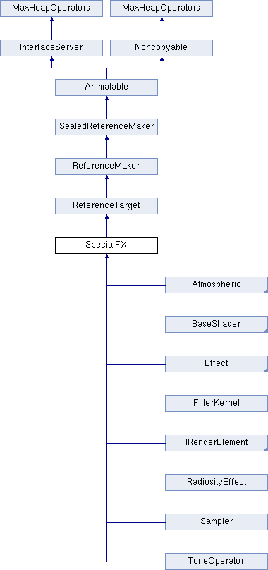

This is the base class for Atmospheric, Renderer Effect, and Shader Plug-Ins. It contains a few methods common to each of those plug-in classes.
Data Members:
MSTR name;
This is the name which appears in Track View.
+ Inheritance diagram for SpecialFX:

Member Function Documentation
virtual MSTR GetName ( )
inlinevirtual
Remarks
This method is used to retrieve the name for the plug-in. This name will appear in the track view and the list of current atmospheric or rendering effects.
160 { return _M(""); }

virtual BOOL Active ( TimeValue  t)
inlinevirtual
Remarks
Returns TRUE if the effect is active; otherwise FALSE.

virtual void Update ( TimeValue  t,
Interval valid
inlinevirtual
Remarks
This method is called once per frame when the renderer begins. This gives the atmospheric or rendering effect the chance to cache any values it uses internally so they don't have to be computed on every frame.

CoreExport IOResult Save ( ISave isave)
virtual
Remarks
Implemented by the System.
To facilitate naming atmospheric or rendering effects, a 'name' string has been added to the base class. This method should be called from the developers sub-classed Atmospheric or Effects plug-in to save the name.
Reimplemented from ReferenceMaker.
Reimplemented in FilterKernel, Effect, Atmospheric, BaseShader, and ToneOperator.
CoreExport IOResult Load ( ILoad iload)

virtual SFXParamDlg* CreateParamDialog ( IRendParams ip)
inlinevirtual
Remarks
This method creates and returns a new instance of a class derived from SFXParamDlg to manage the user interface. This put up a modal dialog that lets the user edit the plug-ins parameters.
Parameters:
IRendParams *ip
This is the interface given to the plug-in so it may display its parameters.
Default Implementation:
{ return NULL; }
