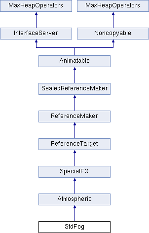

+ Inheritance diagram for StdFog:

- Public Attributes inherited from SpecialFX
MSTR name
- Static Public Attributes inherited from Animatable
static const AnimHandle kInvalidAnimHandle = 0
- Protected Member Functions inherited from ReferenceTarget
virtual CoreExport int DoEnumDependentsImpl (DependentEnumProc *dep)
 Method to perform an enumeration on a ReferenceTarget. More...
virtual CoreExport ~ReferenceTarget ()=0
 Destructor. More...
- Protected Member Functions inherited from ReferenceMaker
virtual CoreExport ~ReferenceMaker ()=0
 Destructor. More...
virtual CoreExport void SetReference (int i, RefTargetHandle rtarg)
 Stores a ReferenceTarget as its 'i-th' reference`. More...
void BlockEval ()
void UnblockEval ()
int Evaluating ()
CoreExport RefResult StdNotifyRefChanged (const Interval &changeInt, RefTargetHandle hTarget, PartID partID, RefMessage message, BOOL propagate=TRUE)
- Protected Member Functions inherited from Animatable
virtual CoreExport ~Animatable ()=0
 Destructor. More...
- Protected Member Functions inherited from Noncopyable
 Noncopyable ()
 ~Noncopyable ()
- Protected Attributes inherited from Animatable
DWORD aflag
AnimPropertyList aprops
